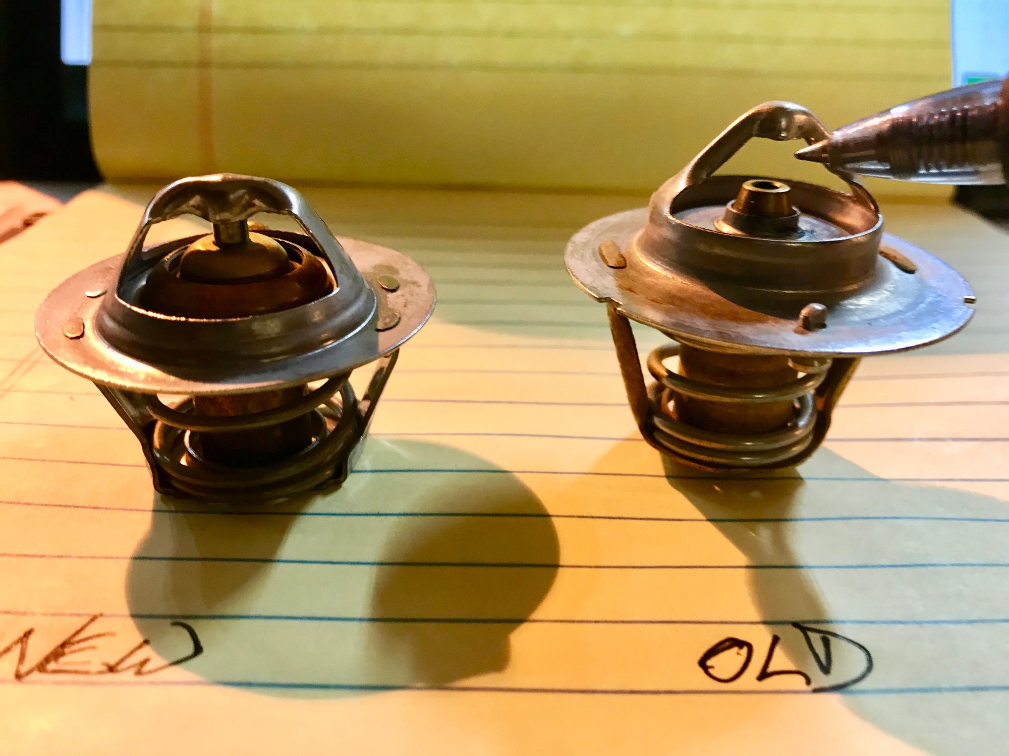

Forgive me if this is a stupid question, but I recently ordered a Genuine Mini thermostat and want to make sure I received the real thing. Does MotoRad make the genuine thermostat? It looks like it has the newer "good" gasket (clear-ish white, silicone?) and the correct temp rating.
Different but related question: Does a thermostat leak after around 2 years seem normal? My shop replaced it around 2 years ago and I've had a slow leak recently (t-stat housing picture below). I'm replacing the thermostat and housing just to be sure (hopefully), but 2 years and not quite 10,000 miles seems like it didn't last very long.
(new thermostat, genuine?)
(old housing with signs of leaking from old t-stat)

I can't answer your direct question but I had a new thermostat go bad in 2 weeks. The pin that presses on the arched part on the top just disappeared,
I got one at an AutoZone, and I "think" it was a Bosch brand and so far so good, [a month so not a big test]
A leak is not necessarily the T-Stat but is usually the gasket or the housing. I replaced the composite housing on mine with an aluminum one and so far no leaks.
BMW has a pretty good system for the T-Stat in that the gasket is in a groove on both sides so it's "captured". But you do need to be a little careful to tighten the bolts evenly. Also you need to make sure the T-Stat is in the gasket correctly. There's little indentations around the outside of the T-Stat that go into little nubs in the gasket. Easy to miss.
The strange thing was the one I bought didn't have the indentations or the nubs so I had to use the old one to make sure the t-stat was oriented correctly.

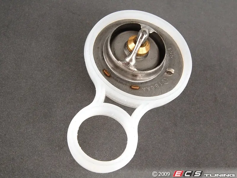

Wahler was the OEM and have the little Chrysler symbol as its shared. Looks like the newer ones say Motorad on the side.
https://www.ecstuning.com/Search/Sit...h/11537596787/
