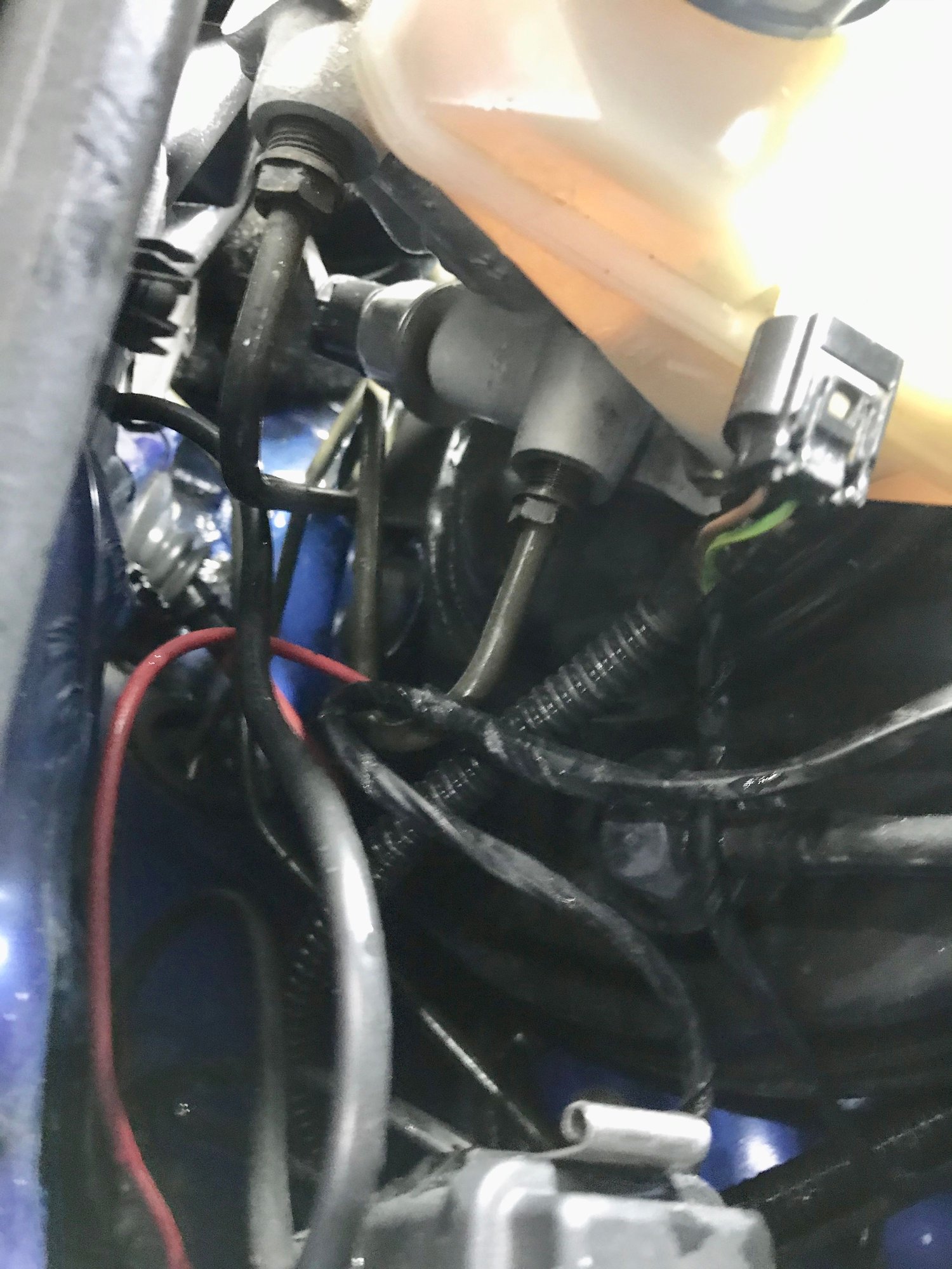

Tried it with brake fluid and again had a leak. It looks like I'm seeing it at the base of the of the M/C at the brake booster.
So I'm guessing a new M/C is in order as the lines and fitting look ok.
My question is could it be anything else?
Fluid is collecting at the bottom where the blue is.

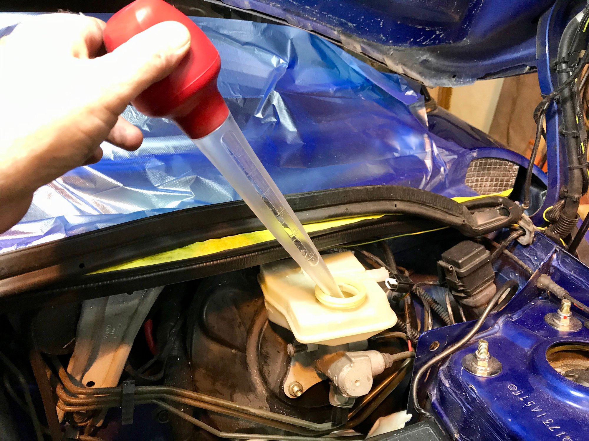

In an effort to eliminate the pressure as the problem I put the M/C cap on, pumped the brake pedal a few times until firm then help the pedal down firmly for about 2-3 minutes. I couldn't quite tell for sure but the pedal may have been sinking slightly. When I checked under the M/C there was additional fluid, so that's pretty much that.
To get to the M/C the airbox comes out along with moving the fuse box all to remove the rear splash guard. I stuffed plenty of rags everywhere, then used a turkey baster to get as much fluid out as possible.

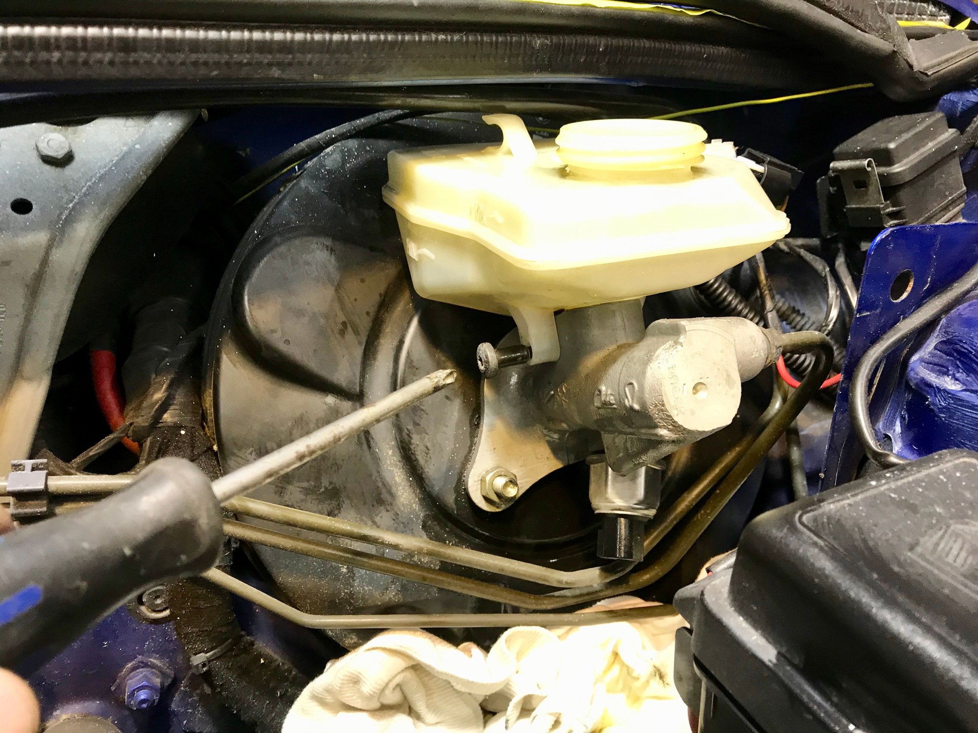

Removal of the M/C is pretty straight forward. Remove the 2 lines, [11mm] I gave them a shot of BP Blaster first. Then the Torx bolt that attaches the reservoir and the nuts from the studs that hold the M/C on, then separate the reservoir from the M/C [careful with the line to the clutch cylinder-it stays with the reservoir] then slide the M/C out.

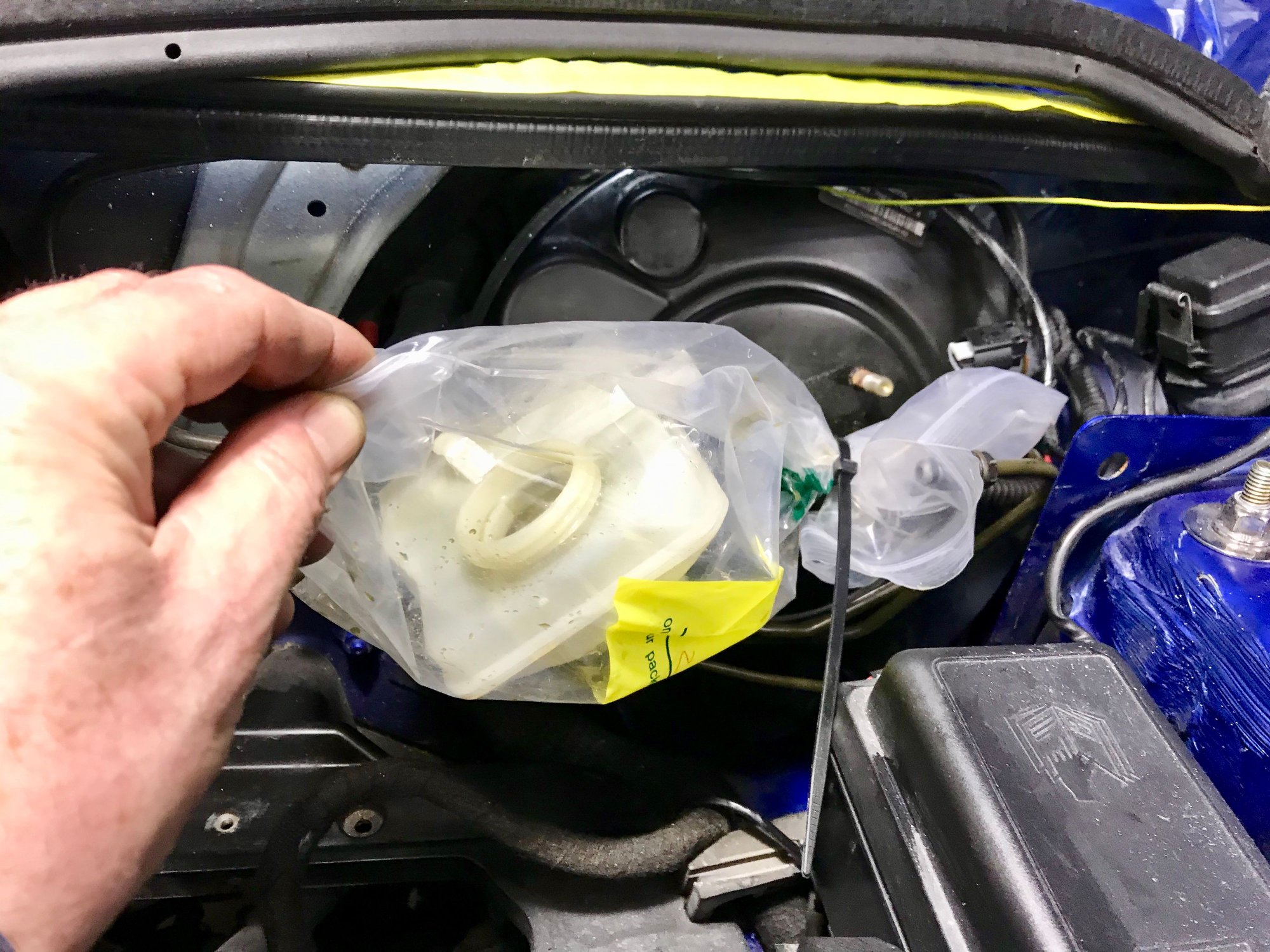

As the new M/C hasn't arrived I put the reservoir on a bag to control any drips, as brake fluid melts paint. Also, be careful where you sit the old M/C it'll leak fluid as well.

Torx bolt holding the reservoir on. Attaching nut below and a second on the top right.
Staged photo. when actually removing the fluid I had a paint mixing cup right there. Brake fluid is nasty to paint. Work carefully.
Bagged and zip tied. if you do this be very careful removing the bag, rags all around!
Took the opportunity to clean up back there.

Possible solution... I think the m/c reservoir may have a leak at the seam in the back when under pressure. On closer examination, the back of the tank seemed wet, and was completely wiped off and dry when installed.
