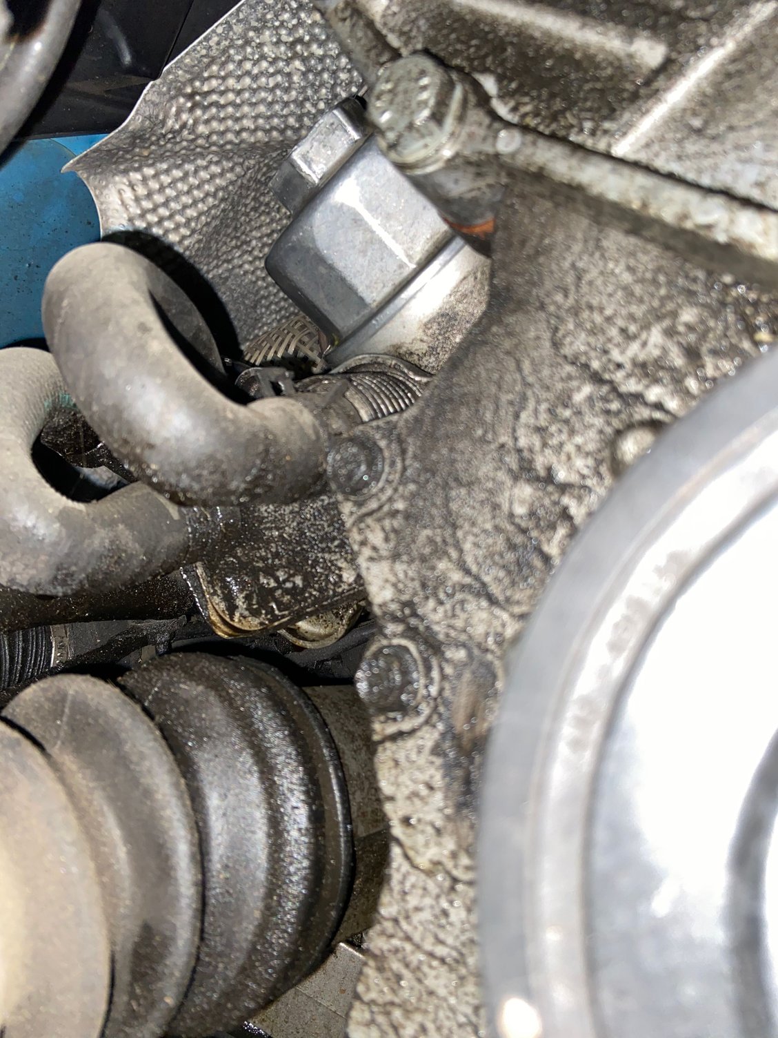

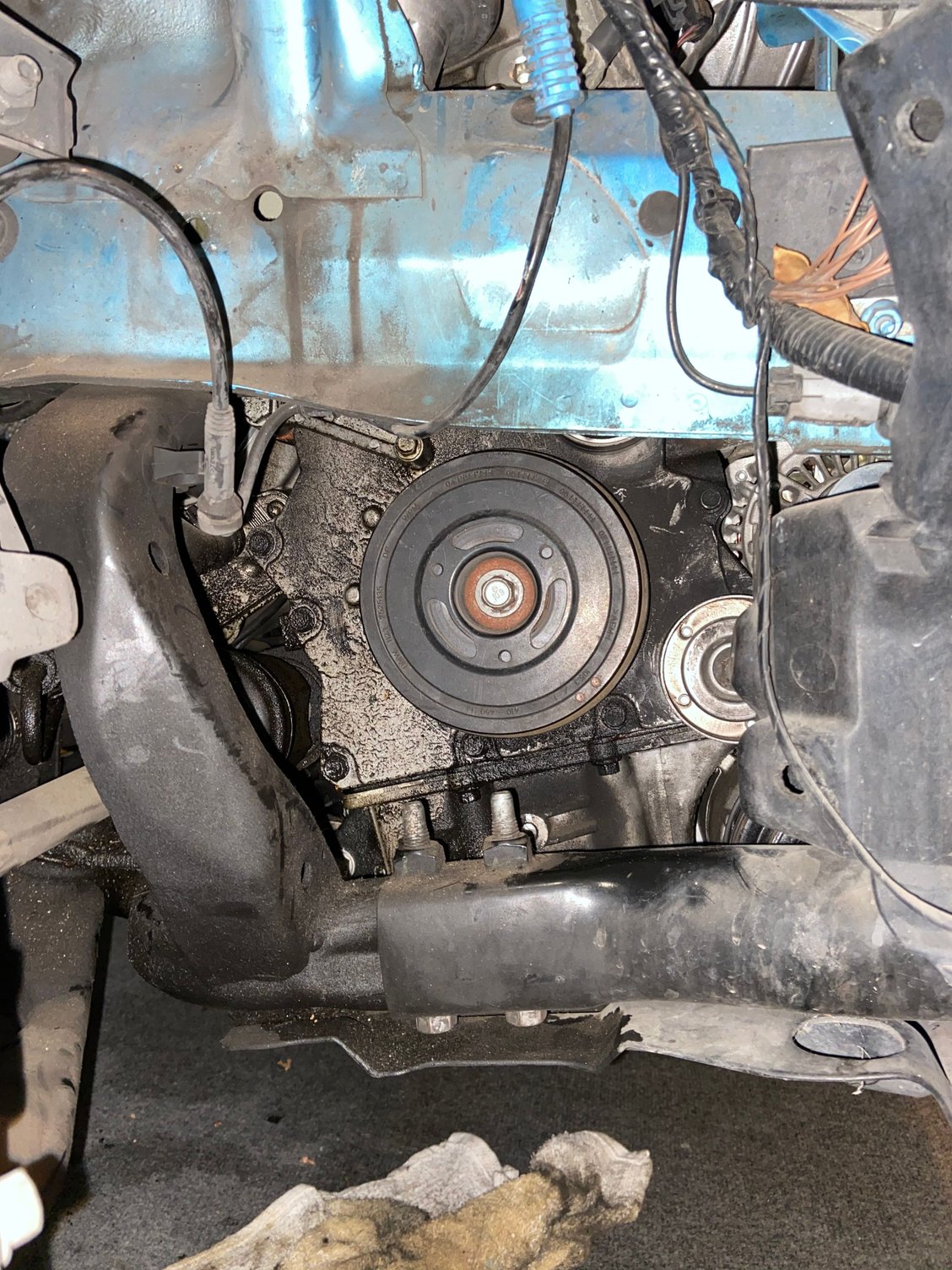

attached are some photos, the block is drenched in oil. Probably from the valve cover leak from up top that I replaced last weekend.
only question I have left: the crank pulley is still on the car right now, but it doesn’t seem to budge or wobble. This shouldn’t dismiss the possibility that it’s still defective, correct? Thanks again guys. Will keep you updated

Correct, there can be no noticeable physical damage or warning, until it just goes.
But as mentioned, it is a consumable part and "will" fail, just depend on how you want to deal with it. And if you purchased one of the high quality (albeit expensive) options, you'll never have to worry about it again.
