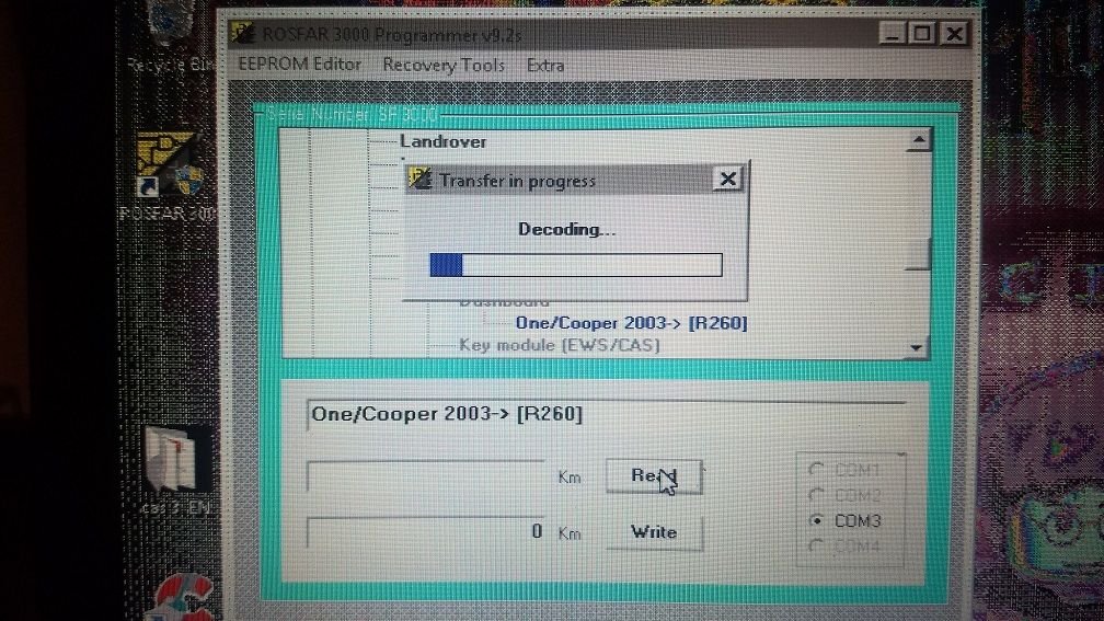

So, after reading this whole thread a several time, I am not far from understanding the process. To start with, I have to buy a R270 v1.20 BDM programmer.
Then do the following:
  1. solder the wires
  2. flash the flash and eeprom provided by the GitHub link (whats the difference between the flash and eeprom?), and I dont have to change anything, just flash the 0km version
  3. Then do a ZCS_LESEN on EWS and a ZCS_SCHREIBEN on KMB
  4. Then do a FGNR_LESEN on EWS and a FGNR_SCHREIBEN on KMB.
  5. Finally, code the KBM module using NCSExpert/NCSDummy (I dont understand this step, what does this step do?)
Am I missing something? Do I need something else? I am trying to replace my sat nav with a simple speedo, no chrono pack.
Thanks!
EDIT: I do need an OBDII-to-USB cable and Revtor profile for NCS-Expert.
Old Apr 16, 2023 | 06:47 AM
  #263
Laup99's Avatar
Laup99
Joined: Jan 2022
Posts: 13
Hi Peter, it's not an easy mod - plenty of opportunities/steps to make mistakes. I would use an R260 programmer for reliability of read/write and solder the connections as shown in the thread - this is quite tricky! Then you upload the processor memory and view in hex, at which point you have a number of options. I chose to zero out the VIN and mileage areas of the uploaded file and flash this back to the kombi. The memory regions for this are shown in the thread. You can also set the kms/miles to zero/desired value using the R260 software odo correction tool. If you do this correctly (zero VIN and miles/kms) then you'll make your 'new' kombi (centre speedo) appear to be a virgin/new part and NCS will allow you to copy all the vehicle info including your actual vehicle milage/kms from another module e.g. Body Module over. After you've done this then you need to recode options and settings for the cluster change e.g. turn stuff off that no longer exists (oil gauges) and the temp gauge has different scale and orientation between centre speedo combo and chrono - gauges are calibrated by angle moved and value in hex. So you have to work through some cal updates. Quite a few cal changes but all quite easy and obvious.
So:
- Buy an R260 and a good fine-tip soldering iron. Upload, save, and edit/zero the uploaded file as the thread. Read it back to check it.
- Do you have NCS setup? If you haven't done this before it can be very difficult to get it up and running so start doing this. Make sure you get all the file updates for R53. Make sure you buy a OBD connector that can switch between pins 7/8. NCS and NCS Dummy aren't easy to use either!
- If you have NCS read the bin files out of your kombi and the column gauges and view the setups in NCS Dummy this will give you an idea of what cal changes you'll have to make for centre speedo and new column gauge.
Not sure what year you car is, but more options are available on the facelift 2004 on cars. I'm pretty sure your kombi and column gauge ideally need to come from the same car - things like same SW build and bus data dictionaries for messaging need to be compatible - check this on the white labels.
If you haven't used NCS and you have a later 2004 on car, a nice easy mod is to turn on the column rev-counter vehicle speed in the LCD display. This is just one cal change in NCS/NCS Dummy but will begin to teach you how NCS works - there's a YouTube video on it.
Hope this helps to get you started!
