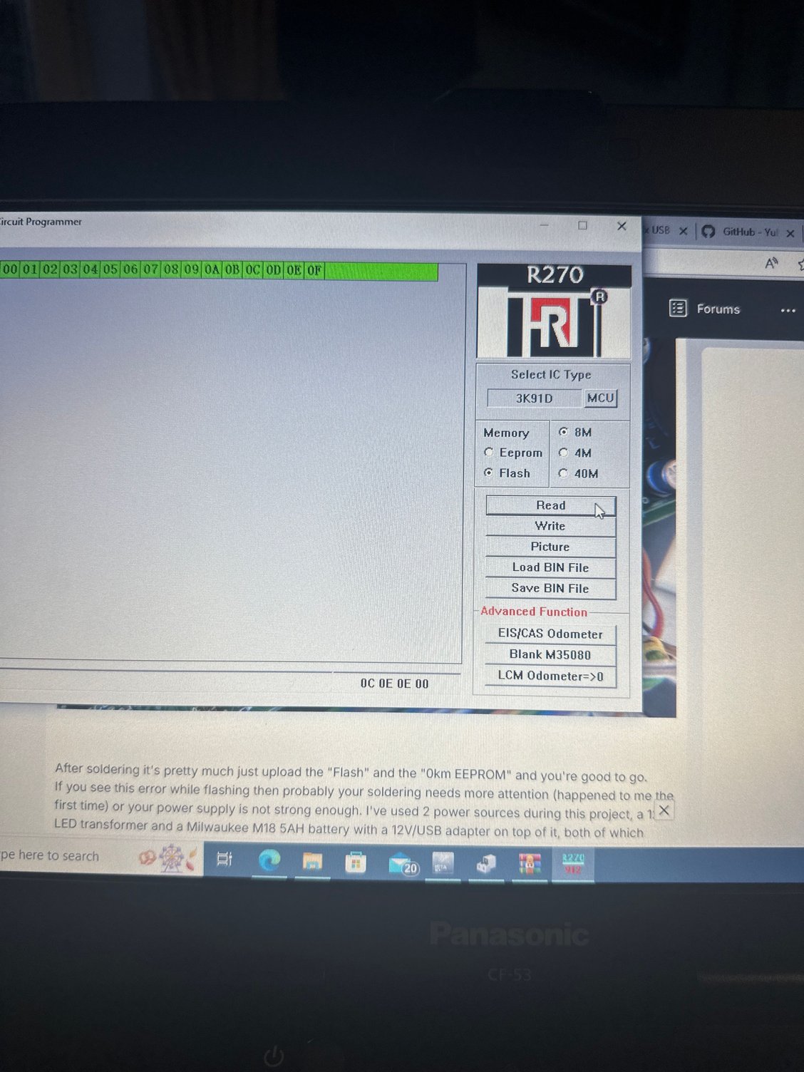

Read eprom successfully with r270.
loaded binary files for 30 I downloaded from GitHub, removed .txt. And renamed from .bin to .BIN
Tried writing the flash (I assume you select flash) and tried writing eeprom with the 0km file.
both said it was “data size invalid” seems to be an absolute assload of commentating in it? The original read was minimal and any commenting mostly gibberish?

Figured it out, you have to download raw from repository, not right click save as from link in the instructions.
then the flash is only 131kb and eepron only 2mb

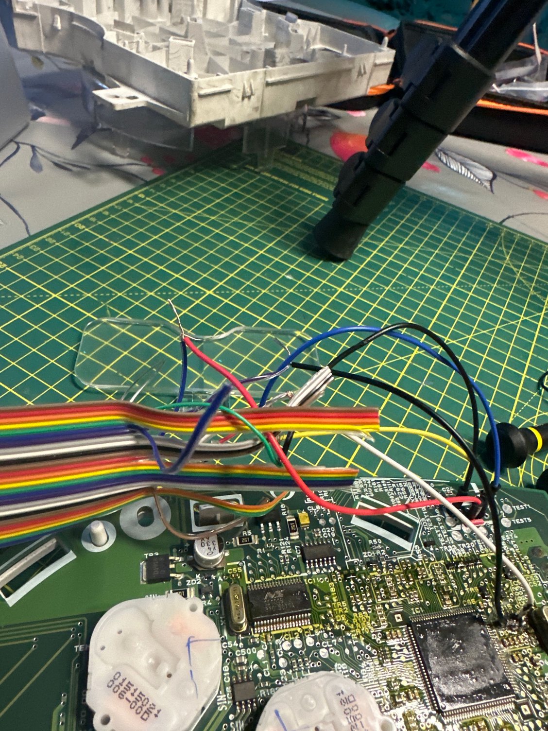

if you have a windows computer, get the r270, install the software and download the flash and eeprom files.
Follow the TDLR directions and strip out the numbered wires from the ribbon cable about 6” back and connect the wires as indicated in the pictures on GitHub.
make sure you can read it beforetrying to flash anything.
What I did to get a good read was tin the only rearmost section of exposed wires after stripping so I could press fit them into the socket holes in the board amd when they got to tinned section, boom. They stayed.
there is only one wire that needed to be soldered in place so I tinned that one fully and just touched surface contact point with iron to preheat, then put wire atop and touched wire with iron to make a temp connection I could just pop free after.
when you have a good connection it will read or flash it in 6-10 seconds, when you don’t it will stall and sit there not actually doing anything for minutes.

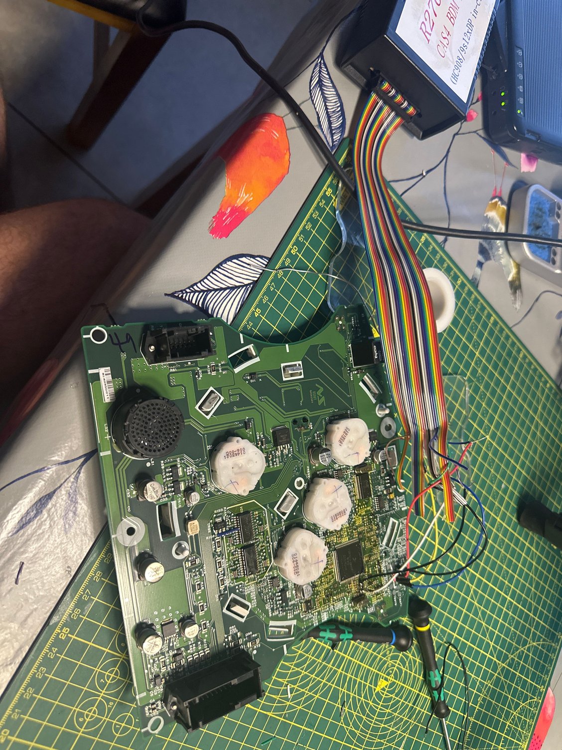

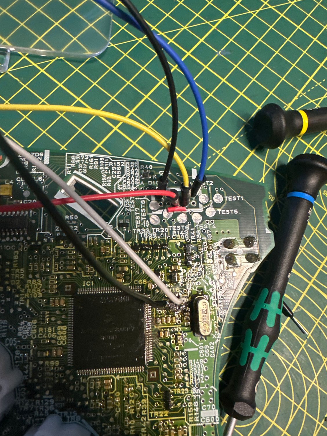

Pinouts and setting correct?
Hi Guys,
i have soldered as below and have the 270+.
im struggling to read the flash and eeprom, where am I going wrong?

I'm having an issue with writing the flash. I can read/write the eeprom and read the flash. Since I'm using a 270+ I'm pretty sure the flash has been corrupted. When I load the flash file that I want to write and then press the write button it just hangs. Does anyone have an idea on what the issue is?
Old Sep 22, 2024 | 09:43 PM
  #293
MayaCSmith's Avatar
MayaCSmith
Joined: Sep 2024
Originally Posted by xeiona
Hi Guys,
I would try it without the extending wires.

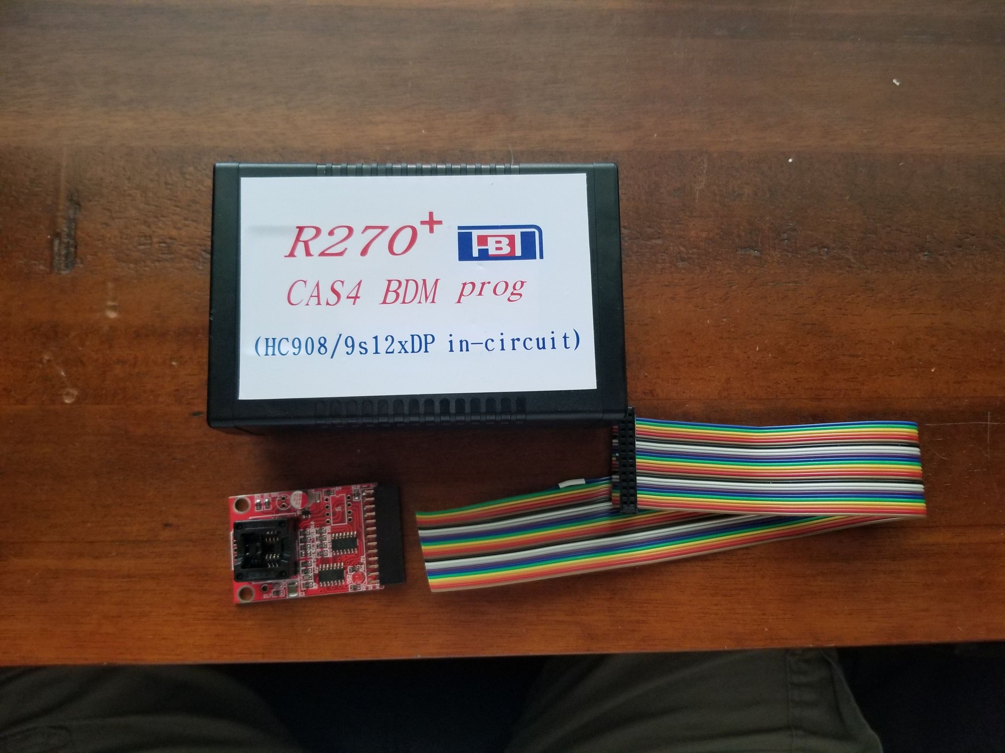

Thank you for your prompt reply. I purchased an R270 kit pictured below (it came with USB & power cables, not pictured). The problem is the colors in the ribbon cable don't match the color / position number in @YulCmr github instructions. What am I not understanding here? Could you send a picture of the wires you soldered to your board? is your ribbon cable the same as mine? Mine starts with blue (labeled 1) then proceeds green, yellow, orange, red, brown, black, white, grey, purple, then repeats that pattern for a total of 26 wires. Below are @YulCmr instructions, but as you can see, they don't match my ribbon cable colors; plus I don't have a coaxial cable in my kit, nor is there a place to plug one in. Wire color :
  • YELLOW = RESET
  • PURPLE = BKGD/BDM
  • BLACK = VSS/-
  • RED = VDD/+
  • GREEN = PE7 / xclks
R260 - R270
  • Black / GND / 26
  • Red / 5v / 1
  • Yellow / RST / 7
  • Purple / BKGD /19
  • Green / XCLKS / 5
Coaxial
  • White / ECLK / 8
  • Black / ECLK_REF / 24
What programming device did you purchase? Did your ribbon cable match @YulCmr instructions? What am I not understanding here?

Hello, I have bought a Cooper S and I’m trying to retrofit the Chrono Pack. What an incredible job you’ve done to make this possible for "normal people"!
I have an R270+ programmer and have read all the posts and @YulCmr GitHub, but I have one doubt regarding the coaxial pinout solder points, as the picture is not very clear.
Could you confirm if these are the correct points?
These are the correct ones
Orange - GND CLK
White - ECLK
