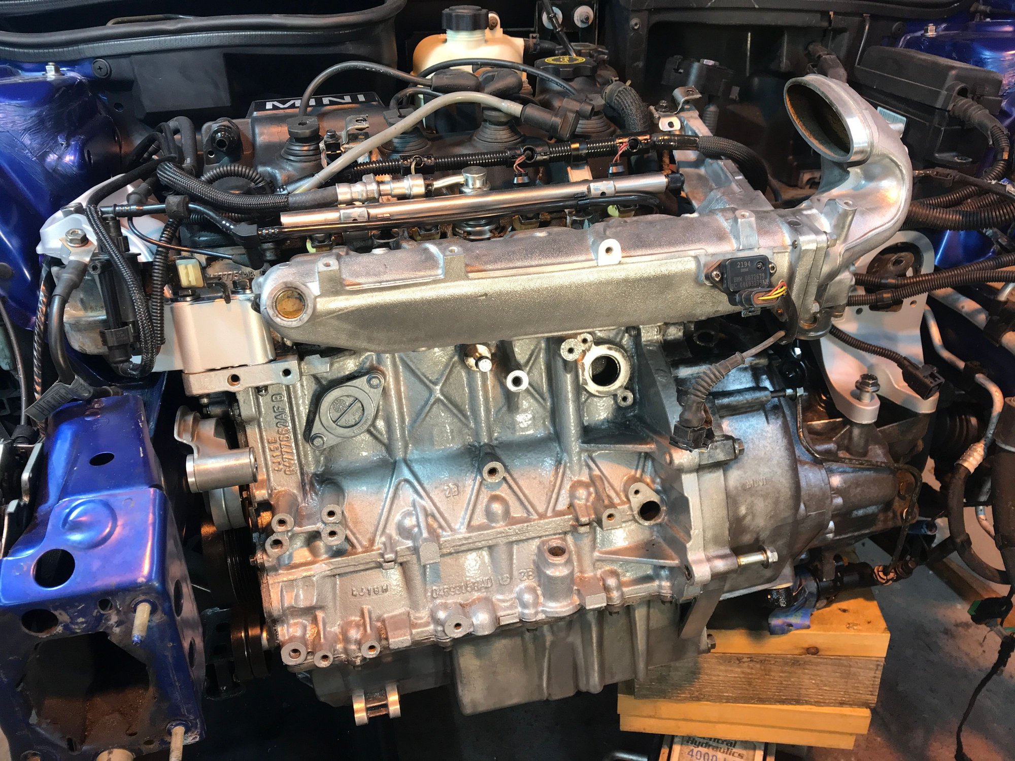

Tidying up the engine compartment while awaiting parts. Trying my best to stay out of trouble...
