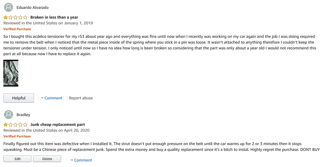

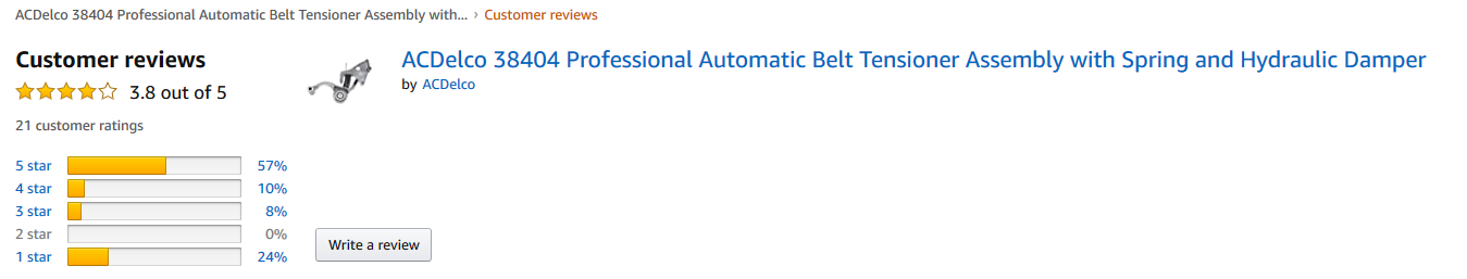

I bought a replacement Belt tensioner pulley just because I replaced the harmonic balancer pulley and idler pulley. Turns out it was a defective piece of garbage from the start. It makes a weird noise for 2 to 3 minutes and then runs quiet after that. I think all the replacement parts are the cheapest crap money can produce and are farmed out to China to manufacture. Here is a screen shot from the Amazon review I left and another guys. Although this is a different brand, most are just garbage
