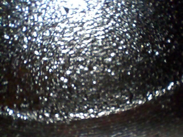

It sounds to me like a minor head gasket leak. It runs rough initially because there is a little water in the cylinder that prevents it from running, but it clears up as the air flow of the engine dries out the cylinder. If you can, use a borescope and look at the pistons. If one is very clean then you have your answer.

I wouldn’t say ones super clean but looks different from the rest. Still does not explain the cam code.

The third one definitely looks suspicious. I would let it sit overnight and see if any coolant puddles inside.
As for what to do, I would clean the carbon off the piston crowns and also check the cylinder walls for excess wear, especially the third one. Another possibility on number three is a leaking injector. the excess fuel could clean off the carbon and puddle in the cylinder overnight, causing a similar condition to a mild head gasket blow.
Cars been sitting with plugs out and valve cover off for a few days now. If there is nothing puddled up as of now there won’t be if I let it sit longer. Runs like crap as of now so still not driving it till I get some parts in. Also not sure why they posted like that but the clean one is the first one on passenger side of the car if that matters.

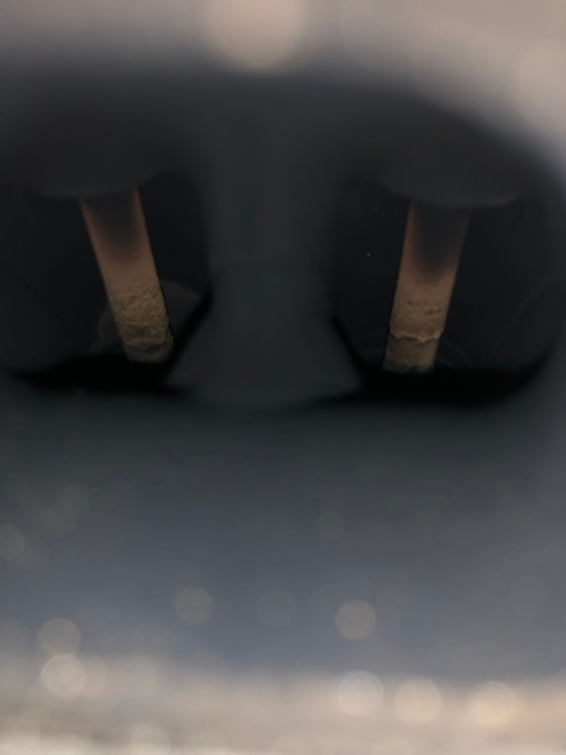

So popped the head off today and this is what I am working with, some things concern me...
Scarring on all large lobes of the cam, 2 pics of it below
All intake valves look clean, exhaust not so much
#1 looks cleaner then the rest

The valve guides from the factory were never good and while you have the head off, at least you need to see how worn they are! They are known as a weak point on these engines! If they and the valve stems are worn, the valves will not seat properly, while it is running. Why do the other work, if you are not going to do this? After all, you want it to run as best as possible, once it is back together. This is the best time to do it! Take it to a good auto machine shop, as it is important to get this done right!
Things to know:
Only use 100% synthetic motor oil.
Replace the cam chain tensioner with a new and tested one( there are many no good new ones out there).
Check that the vibration dampener is in good shape, as they are known to fail about 100% of the time. An aftermarket one is your best bet.
Do not use an air filter, that needs to be oiled. (this is a common problem with run ability issues. (fouling the map sensor and throwing codes, that can put your car in creep mode at the worst times possible)
Use NGK BKR6EIX or NGK BKR7EIX spark plugs (they will keep you smiling!)
Factory coil, they have proved to be the best option.
Do oil service on supercharger and check the pals on the waterpump, to make sure they are not broken.
Replace the fan speed control on the radiator shroud, if the low speed fan is not working.
