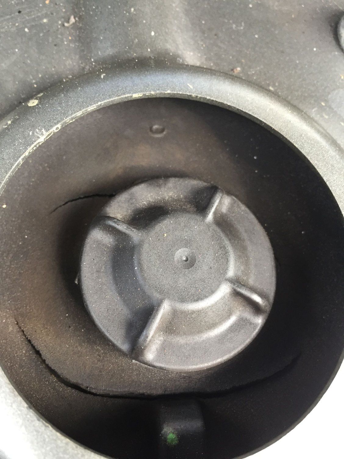

What are these and what do I replace them with?
More cracked rubber on my ‘02. Can anyone tell me what these are?

Strut top mounts. https://www.pelicanparts.com/catalog..._pg2.htm#item7 |
Not too hard to replace, just borrow some spring compressors and have an impact gun handy (electric works just fine)

Get the Lemforder brand.
Same as genuine MINI but much cheaper.
Many of the other brands are inferior in quality.

While you are at it, mount a pair of strut tower defenders. For example:
https://www.waymotorworks.com/oem-fr...rut-mount.html
and while you're in there, they've got bushings:

+1 Strut Mount Bushings (your photo is a BAD one)
Easy fix a couple of hours and a six pack to celebrate after ...
Best of luck.

Watch this "how to" from Mod Mini. He has many useful video's on youtube.

More DIY help here:
https://www.northamericanmotoring.co...ment-tips.html
