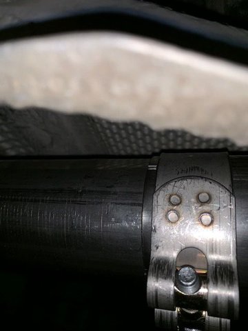

I was wondering about the clamp for the link pipe and if it should sit flush with the link pipe's slotted edge opening. I'm including a pic for reference where you can see I have it a little behind the edge of the link pipe. I wasn't sure if having a little inside is better or worse for possible leaks. Also, is there a torque spec for this? I was thinking of torquing it to the flange spec, 45 ft-lbs. I'm realizing now that the 1/2" torque wrench is a little too bulky for the flanges too so I'm just going to try to get it nice and tight and then I can torque them properly when I receive a 3/8" torque wrench this week. I definitely don't want to play around like this with the header bolts though.

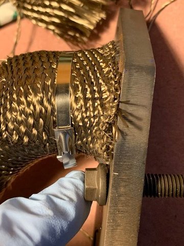

One of the holes for the header bolts had a little tiny amount of welding that didn't allow the bolt to sit flush against the header's surface, but it looks good now that I have it tightened so maybe it squashed it? It was very small, probably around the size of a grain of quinoa or maybe a tiny bit smaller. p.s. I'm not in love with quinoa. I just can't think of anything else haha. Photos as well for that.
