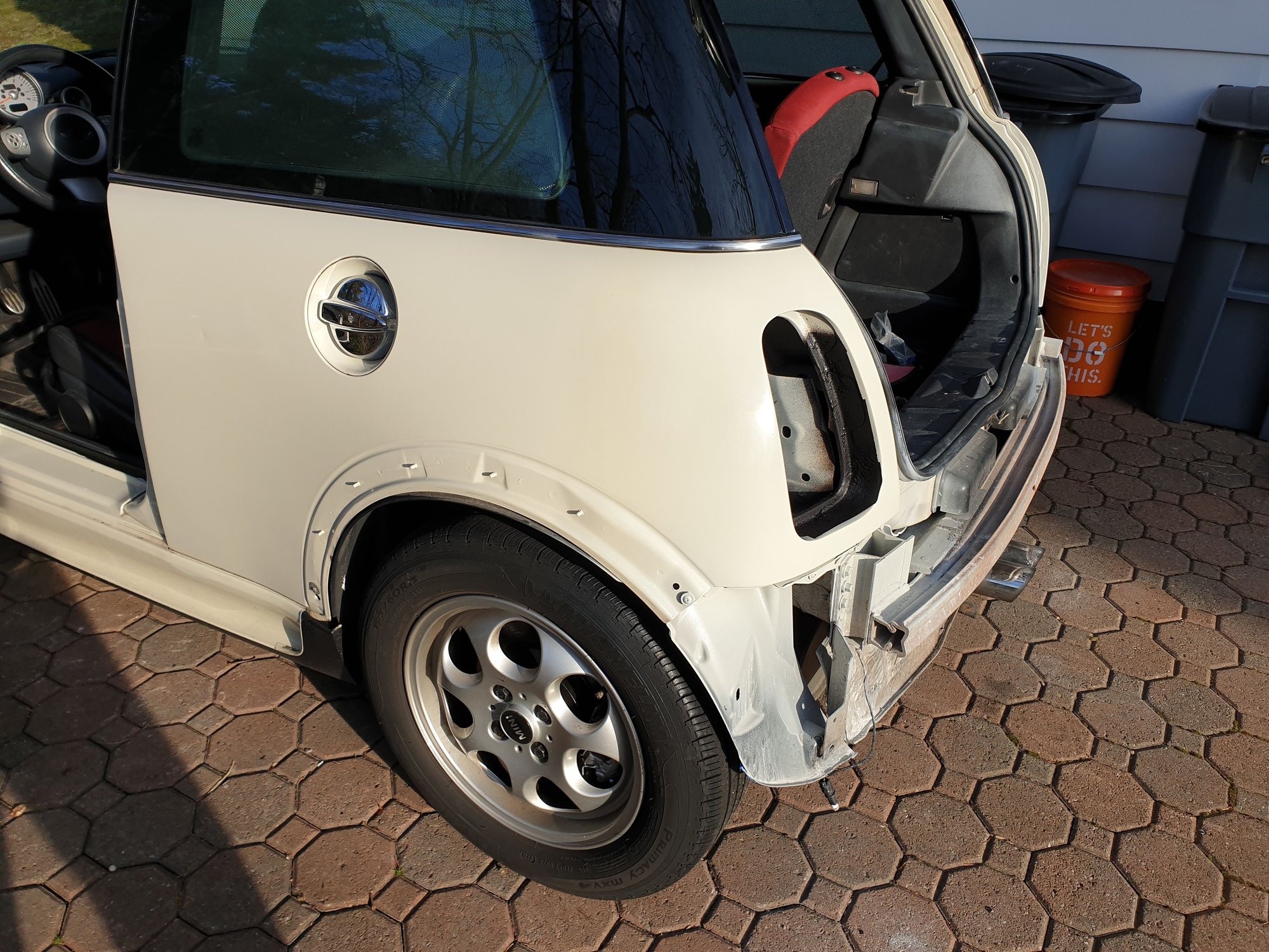

Temps were "ok" today 42-45 so I decided to give it another go. This time I *REALLY REALLY REALLY* put on a LIGHT mist of primer as the first coat, let it sit for like 1 minute, then gently pointed my wife's new $200 hair dryer to give it some gentle heat. Then I let it sit for another minute before applying a second REALLY REALLY REALLY light coat on. Then rinse and repeat I ended up with 5 light coats of primer.
I let it dry for 2.5 hours (instead of the 1 hour on the can) and came back, sanded with 600grit dry, wiped with degreaser, and then applied 2 REALLY REALLY light coats of base coat paint.........
AND THEN I FRIGGIN RAN OUT OF GODDAMN PAINT GODDMAN IT. SO NOW I HAVE TO WAIT AGAIN FOR THE PAINT. $(*&#(*&^@#(*^&%*&$^&^#^&$(y&*)@!g*y$.
Last time it took 11 days to process and now with Thanksgiving jesus christ I wonder how long it's going to take. Goddamn it to hell.
But at least I got something on there so I won't have to worry about moister penetrating with the car cover.
So here are pics after the 2nd coat of super light primer........

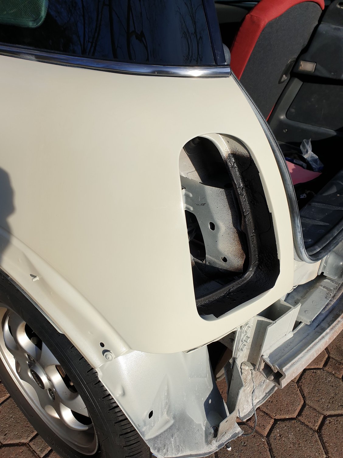

Here it is after 2 coats of paint.

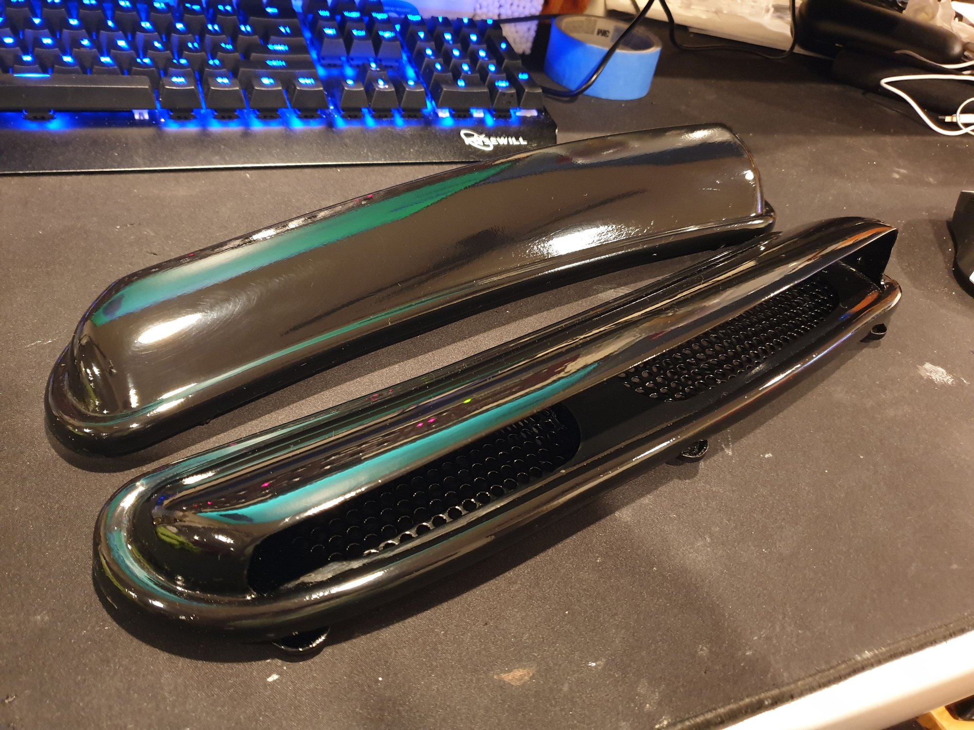

While I'm waiting for the damn paint to arrive, I painted my cowl scoops on my 06 GP.
Anyone want to guess what color they are? I've included before and after pics.
Not perfect but much better than what was there before. I painted them originally back in 2004 when I had my 04 MCS and as you can see the clear just eventually peeled off.
In the below pic I used 3M Scratch Remover on the left cowl and had not applied it yet to the right (by hand).

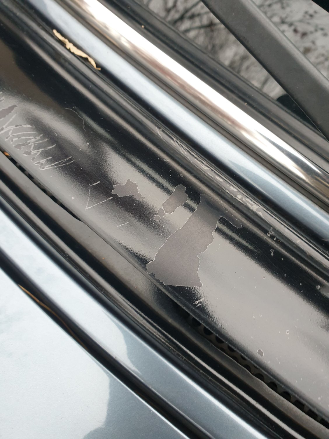

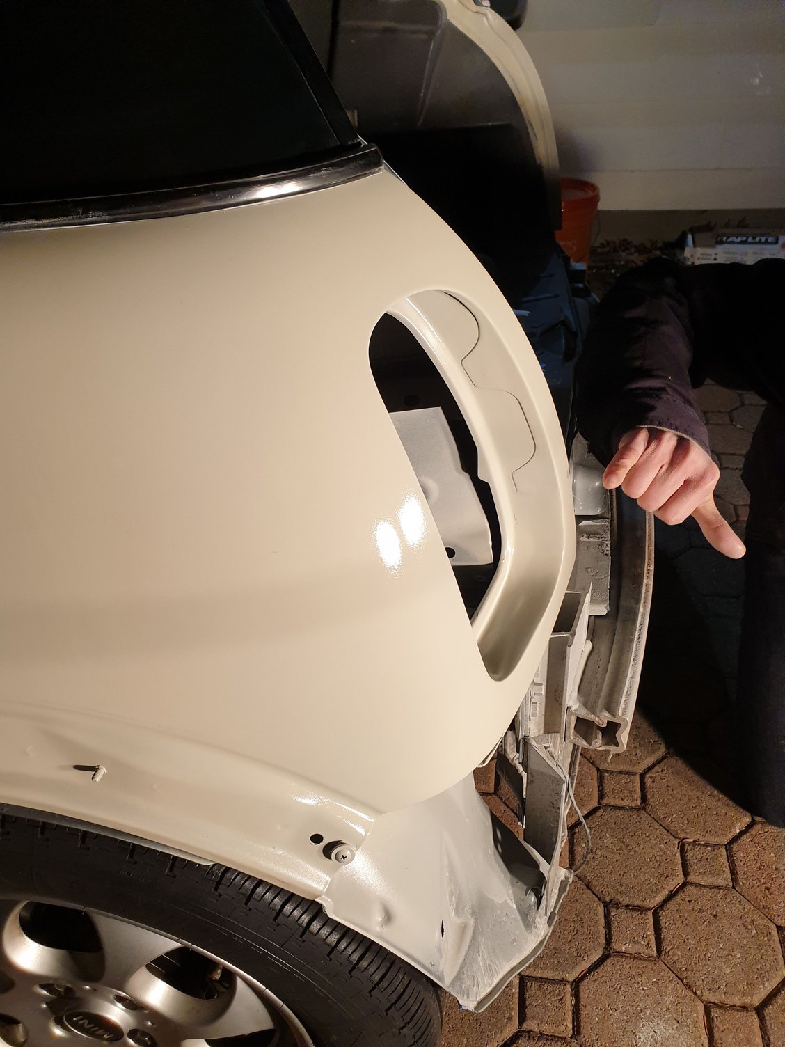

Ok today is Thursday. I let the clear dry for 3 days and it's about 39 degrees outside. I wet sanded with soapy hot water in a spray bottle, a sponge, and 1500, 2000, 3000, and 5000 sandpaper. Then I buffed with a wool attachment and 3m Scratch Remover. I'd say it came out pretty awesome. It's definitely NOT perfect - in fact I probably should have put 2 or 3 more light coats of base paint on there.....I can sort of see the primer on the passenger side........Oh well, first time doing it so I'm ok with that. Main goal was to stop the rust, build the body back up, and paint it...............and not spend oodles of $$$. Mission accomplished. I'm sure if I had done it in the warmer months I would not have had these issues. However, many lessons learned.
I also spent the day scraping away the rust in the door sills on this car. Sprayed some rust reformer on them, let it dry, then hit it with the 3m Rubberized undercoating.
Here are pics after wet sanding:

Here are pics after polishing. I did get a little chip on the inner part of the taillight recess so I decided to hit the inside of the driver side taillight with the 3m rubberized undercoating as well. The passenger side has it already but the overspray from the paint kind of hid it.

And here are pics of the rust in the door sills.

Thanks. It ended up pretty good.......for now..... I learned my lesson on painting in the cold. I did put quite a few light coats of base (at least 5).......but when it was wet it looked like it covered the primer just fine..........days later not so much! So I can see the primer behind the paint faintly.......and you can' t really tell in most of the pictures........I should have laid it on thicker on the last few coats.......
But basically my advice is get a heated paint area unless you absolutely have to do it outside like I did.
