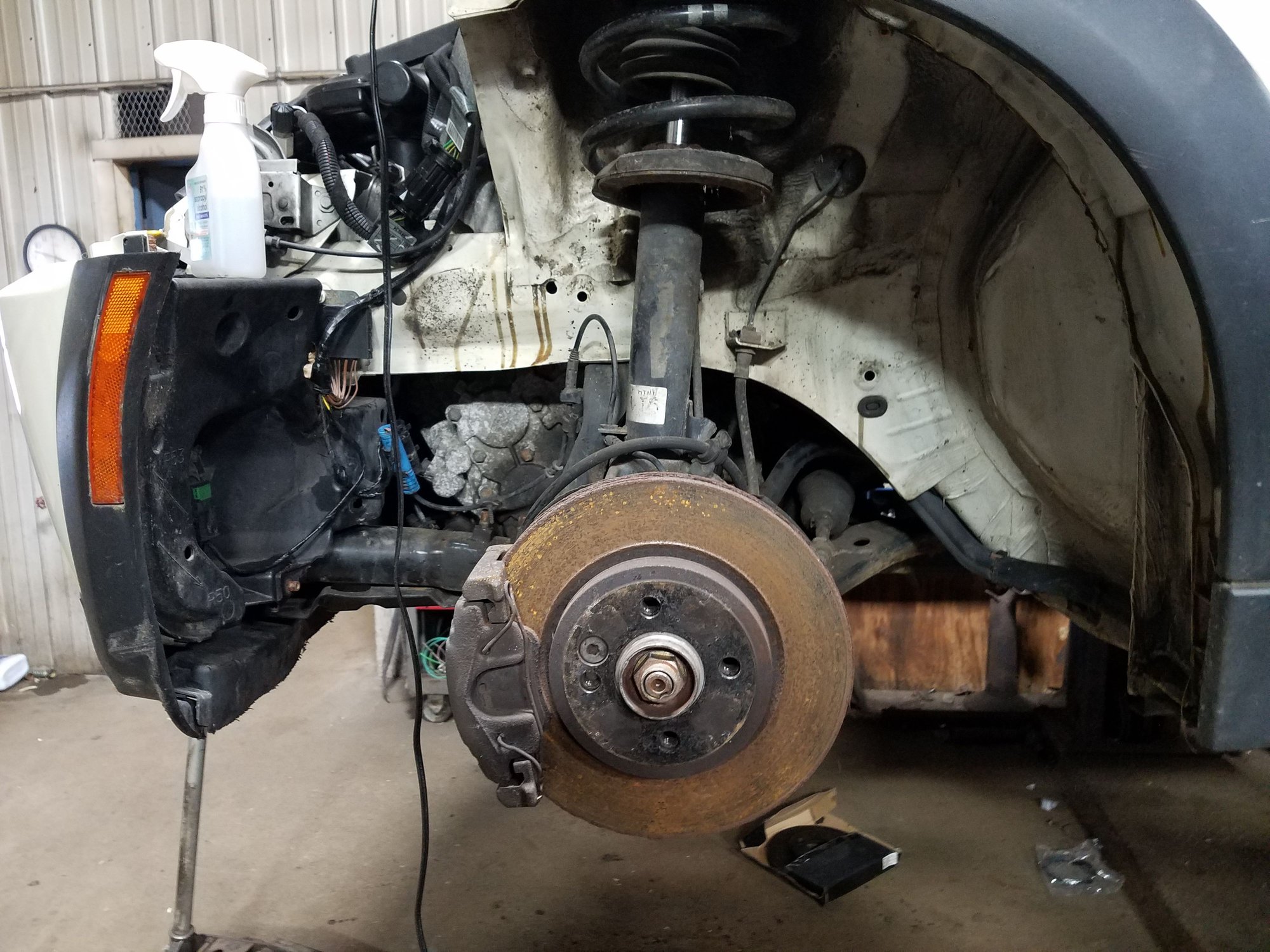

Nice shiny and new! Your MINI will be running smoother with the PRW and handling a lot better soon.
Looks like the Swift springs lower the car a similar amount to the TSW or older H-Sport springs. Planning on trimming the bumpstops? You may or may not need to in order to preserve some suspension travel. I had to trim the stops with the H-Sport springs. I lopped off about 20mm from all of them. (For the record, I removed the top part of the stops.)
I see everything but swaybar bushings and outer balljoints, you planning to replace those too? I regret not replacing the swaybar bushings since I had the subframe out, oh well....

I spoke with Collin from Greene Performance and he said no need to trim the bump spots. So i left em alone.
i am going to remove the lower arm and swap the bushings that way. Hoping i can do it all without dropping the sub frame. I probably should do the other ball joints now. But they seem pretty solid still, as do the tie rods.
i don't know what i wanna do with the sway bar yet. Stock or poly? I know an aftermarket rear bar will happen.
i installed my PRW pulley Friday. Every thing was going very smoothly, that is until i snapped my brand new crank bolt off inside the crank...
On Saturday i spent 5 1/2 hours drilling, swearing, bleeding, tapping, and swearing some more working it out.

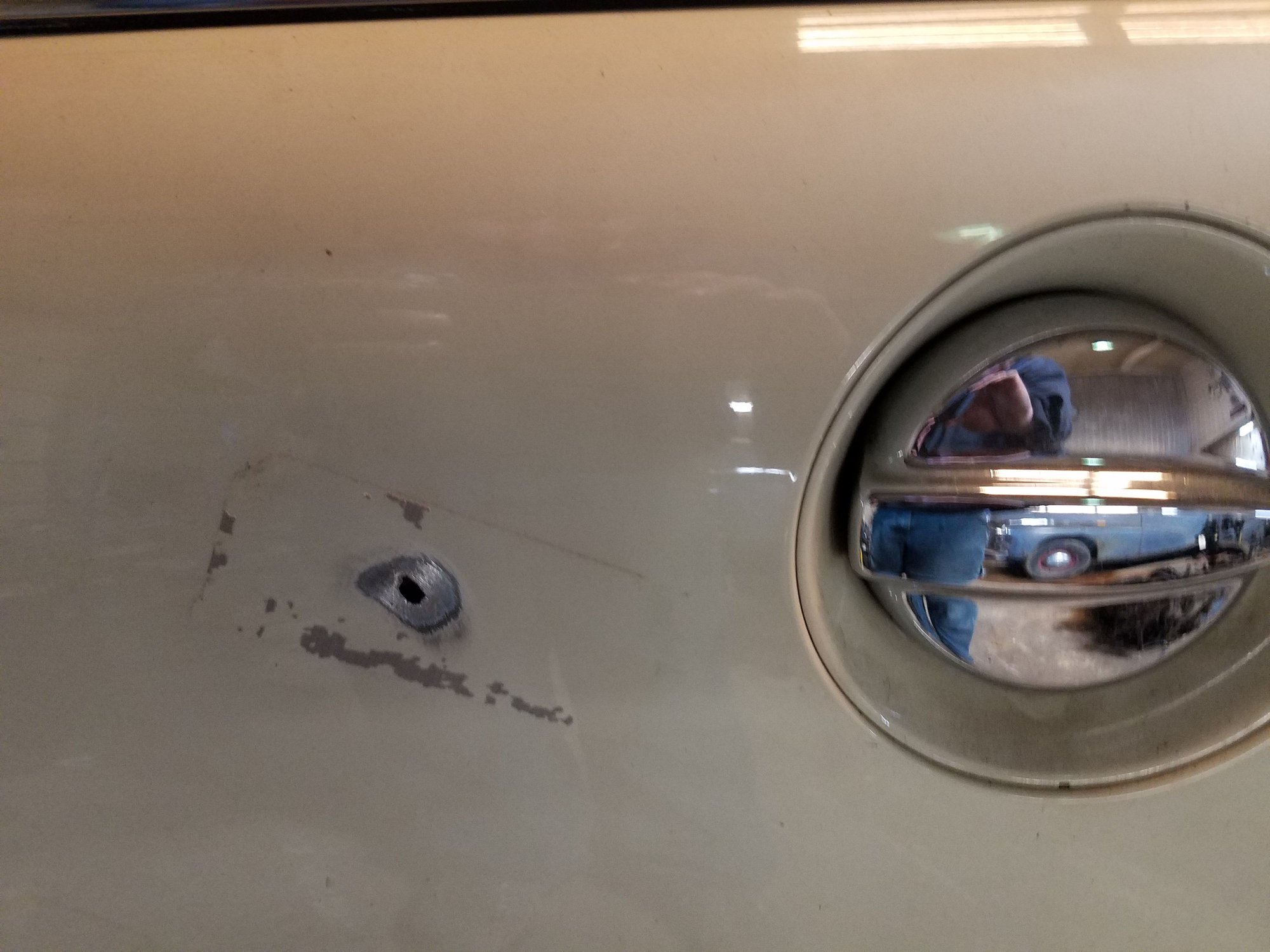

a quick power wash and it doesnt look much better. You can see i have a bit of body work and paint to do yet. Hoping to have everything buttoned up in a month or so.

Just finished some suspension work. New Bilstien B4s, and Swift springs. Powerflex control arm bushings, all new ball joints.
Did the rear wiper delete.
