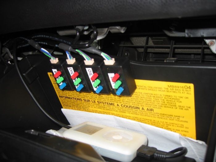

See this: https://www.socalevo.net/threads/136276-OMORI-Gauges
The gauge has a control to set the color to whatever you want.
Do you have an RGB **** control like this somewhere in the car (this person has 4 Omori gauges — you would only have one of these controls):
I have two gauges. I don't think I have this RGB switch somewhere, except if it is hidden. It probably lights up orange just to show the color but there is no warning unless it goes red and then it means it is hot.
