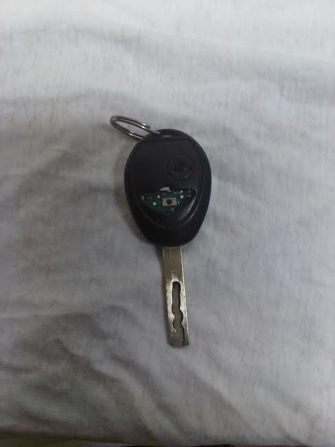

I was given only 1 broken key when I bought my '03 MCS, that's all the dealer had. The old key will lock/unlock the doors and start the engine. I really need a new key in case this old one quits working someday. I would really appreciate your guidance on how to go about getting a new key...is paying a Mini dealer a small fortune the only way to go, or ??

You bought that from a dealer and that's what he gave you? And you only have one key? Your 2003 came with three keys. Two with a remote and a small black Valet key.
Anyway, this thread will give you everything you need to know to refurb your key. And if you want to have someone do it for you, then Val will do it for you for a reasonable price.

I purchased a second key from the dealer, it's not too bad. I'm thinking $150 ish? It was a pretty quick and painless process.

+1 for refurbing the key, I did one and it was super easy. I think that the only option for replacement keys is to go through the dealer because of an immobilizer chip, or some witchcraft like that.

Rich is only partially correct. The early cars came with a remote key (which you have), a "general, non-remote" key (which I'm going to recommend that you buy another one of) and a valet key (your option to buy).
The "general, non-remote" key is a good, low cost option for those who need a second key just to have on hand. It's around $100 at the dealer and arrives ready to go. Early cars such as yours will need to have the remote key programmed into them (you program cars, not remotes) and it will cost an hour of dealer shop time for them to hook your car up to the computer and do it.
The only place to get a real key that will work on your car is at a MINI dealer- don't be fooled by eBay or other on-line key sellers. The theft protection part of your key is very hard to duplicate and that's for a reason.
That said, I do work on MINI keys and can take a look at it- perhaps it just needs a new battery and case- the switches on the circuit board seem to be intact. Do the remote functions not work?
Send me an e-mail to "minikeyhospital@earthlink.net" if you need help with your key. My rates are reasonable- much cheaper than a new key from the dealer.

Thanks Val, I do intend to let you fix my remote key once I get the non-remote valet key. As soon as my Title arrives in the mail I will go to the dealer to order the manual key. Be back to you soon.
