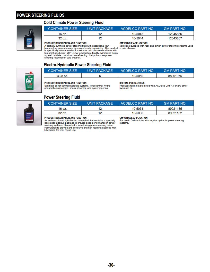

The ps fluid that comes with your Mini is a completely different kind of blend from the ac delco. The Ac delco is a light bodied mineral oil, the other is a synthetic. The manufacturer specifically says to NOT mix them!
If you read this chart you should see the difference. One is designed for an electro-hydraulic pump, the ac delco for a standard gm pump.
Thank you very much dear for nice info
