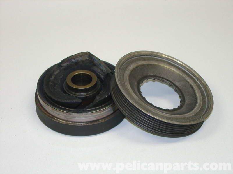

Bad crank damper.

The harmonic balancer is one of those items on the MINI that seem to be a "when it fails, not if it fails item." When the balancer fails, it separates into two pieces, causing all of the accessory items driven by the serpentine belt to stop spinning. However, the harmonic balancer was redesigned for the 2004 model year to address a problem with the old design. I'd investigate further. Did you smell burnt rubber? This is what the one in our R53 looked like. Here if needed: http://www.pelicanparts.com/catalog/..._pg1.htm#item1. More info on it in this NAM thread HERE.

I had this happen to me, too. Lost power and threw a few lights. My pulley was spinning and slipping.
Replacement wasn't too bad.
