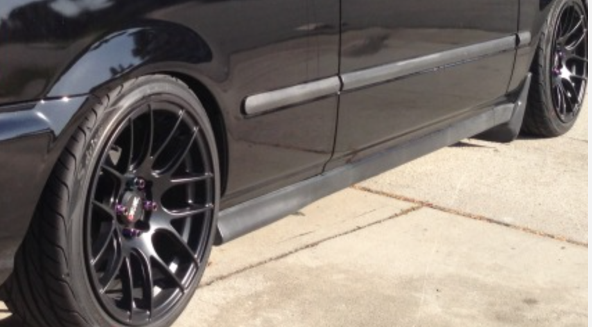

I thought on get tires wide smaller than the rim and then look like "JDM" but not too much. Just a little bit (I will attach a picture of what I mean). Maybe 195/50/16 or 205/45/15.

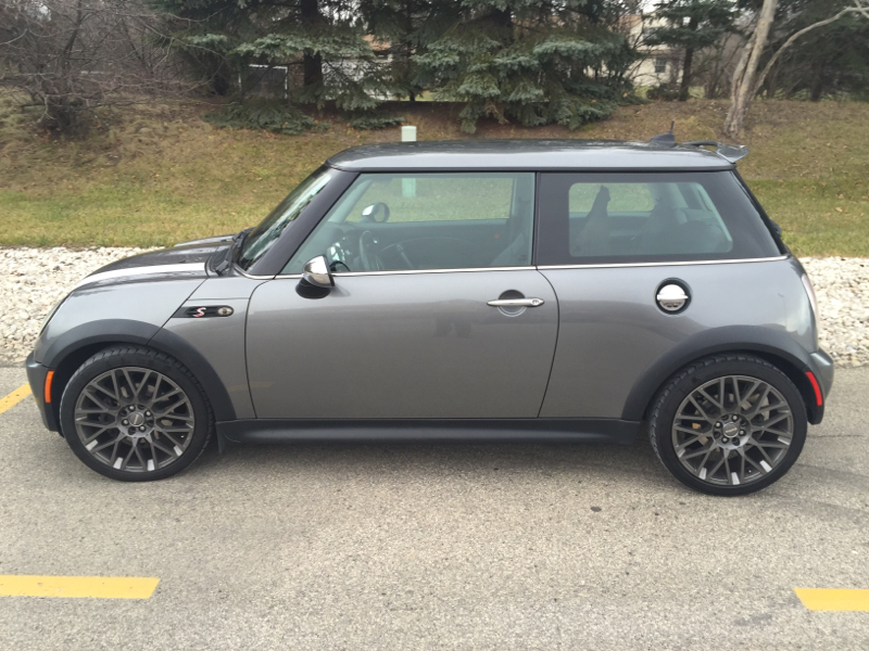

Thanks!!! A PITA to keep clean, though...
Trending Topics
You're welcome. Ya I bet. My wheels are always caked in brake dust and cleaning is a task. Something that might help with the process though, check out the Adam's Wheel Woolie - HERE. It's what I use to help with cleaning multi-spoke wheels.
