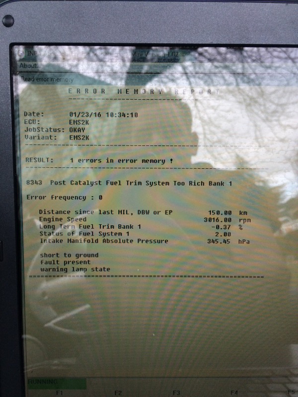

So which one needs replacing?

I'm new to Minis, but I've been working on modern cars like BMW's and Saabs for years. As you've probably learned, the front oxygen sensor is intended to check how rich the mixture is immediately after combustion, so the fuel injection system can richen or lean out the mixture to keep the oxygen percentage precisely regulated to promote full chemical conversion of noxious gasses in the catalytic converter. The second oxygen sensor is supposed to be for quality control, to check the accuracy of the first oxygen sensor.
Keeping that in mind, both the front and rear oxygen sensors become less sensitive at about the same rate as they age. Even though the error you're seeing points a finger at a bad front oxygen sensor, the possibility remains that both oxygen sensors may need to be replaced. That's expensive, but it may be the best thing to do.

Thanks Scot, make sense replaced the first o2 sensor, cleared the code using INPA and also the adaptions. Ran the car and the SES light came back on.
