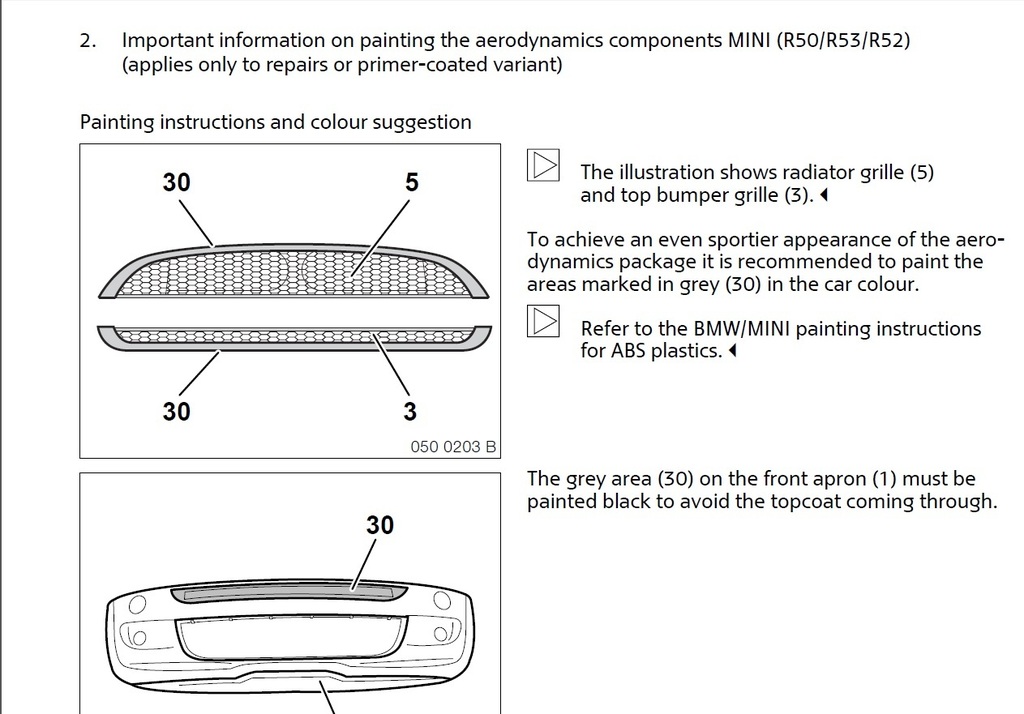

Looks great and really good work. I have a suggestion though. Paint it black behind the thin middle aero grill and if you think it looks good, paint the surrounds on the two upper grills like this:
I was going to paint behind the middle grille but I can't see a difference anyway the BRG is pretty dark when not in direct sunlight. And the black around the fog lights was going to be added in just ran out of time out at the shop, needed to get home.
Yeah your right about the BRG, but I wasn't talking about the fog lights, although I like those done too. MINI actually has an insert for those that look really clean, but they are pricey. I was talking about the outer edge of the upper and middle grills though. Here's the MINI instructions:

Ah I get what your talking about now. No thanks I like it black.
Point is moot though since I wont be driving it until I figure out this electircal issue which I seem to be getting no where on.
