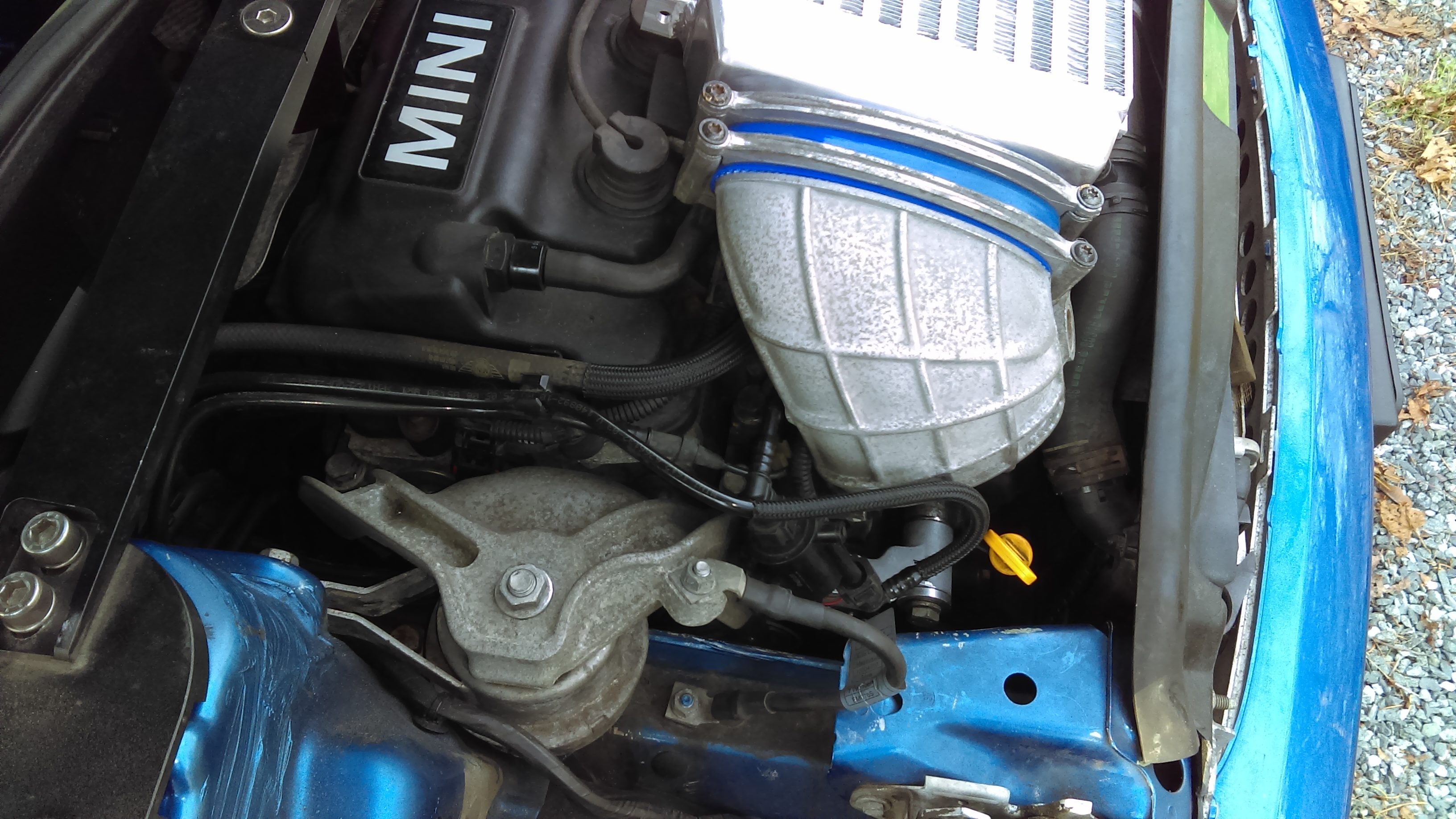

Bogging
Hi. Theres a line under these lines connects to port on thr intake.it can come off when the rubber connector wears out. Take . Look closely under those lines
Hmmmm interesting ill check those out too.

Posts: 100
Look underneath those lines for the one im talking about
