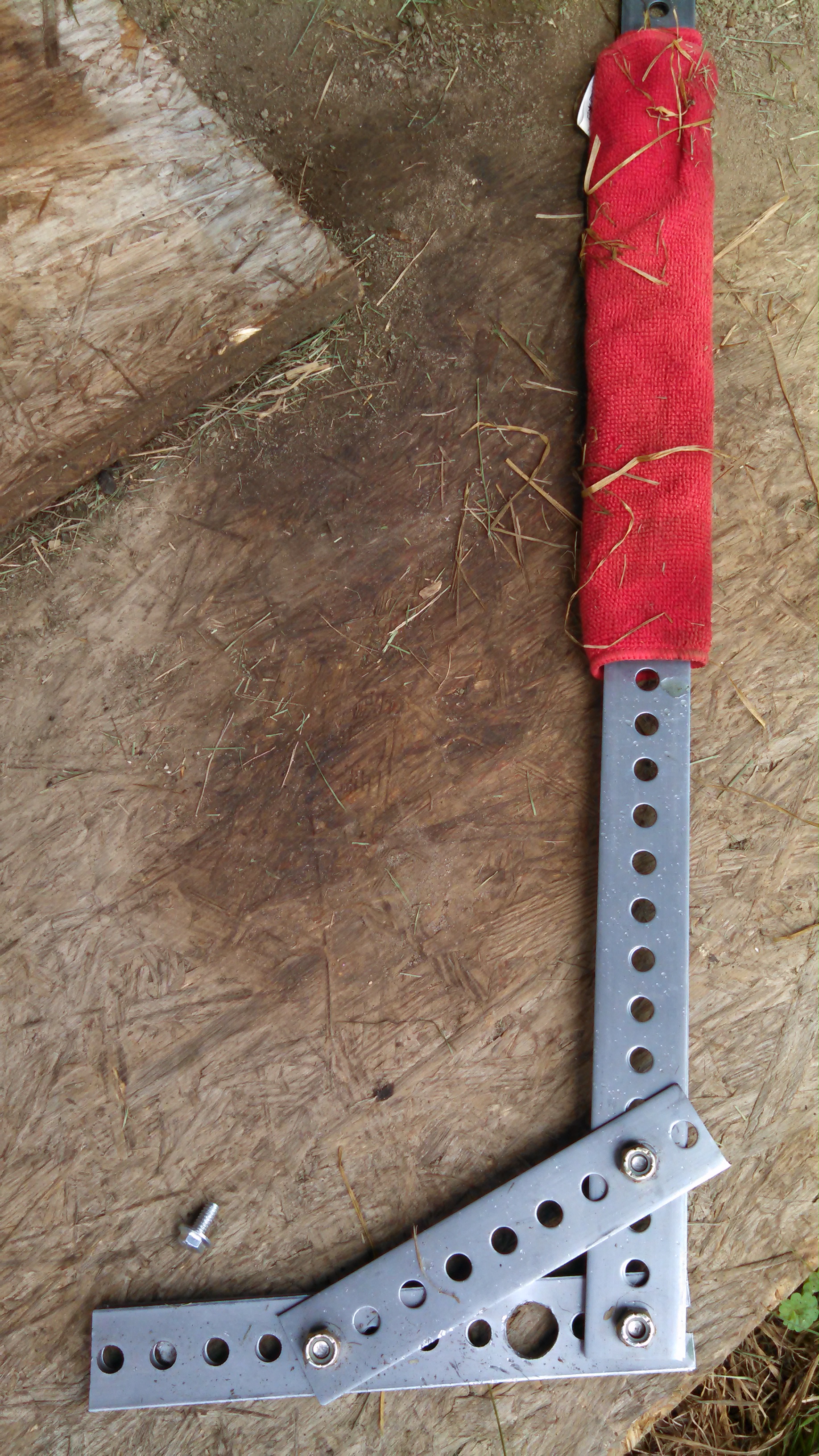

Thanks for checking in! All new parts are in but awaiting the dang serpentine belt tool which has been seriously delayed... About to try a "hack" option just to get it ready to start.
At this time it is all back together except for the belt. Plan to install belt, clear codes and crank it up. Found some degraded injector seals which is probably the source of the gas smell before. They are new now and if no valve damage has occurred hope to be good to go.

All you need is a prybar. Just leverage it against the top sc bolt, put the prybar end in the middle of tensioner and push down. The spring isn't that strong

you can put a spare socket on the bolt as fulcrum...and use a prybar....and depress it...be about a 2 minutes job with a helper...
a "tool" makes it a one person job...
First time i did it without the "tool" i had my wife put an allen wrench as a stopper in the hole to lock it so i could finish the belt change....
Then got a tool...so i could do it without help...

Ok- well I "necked" up a belt tool today since I was tired of waiting for the ordered one. My neighbor helped pull while I set locking pin and it worked after a bit of design tweaking. Total cost $14.00 US.
Serpentine belt on, fluids (mostly) checked, key turned- instant start and purrs like a kitten!!!
Somehow I left off the temp sensor on the cylinder head (novice, I know) so once that is bolted back in should be roarin' down the road. Nice little gush of green fluid to point that one out...
Anyway, looks like successful fix for a $0.00 gifted car. Total in around $1500 US in parts/supplies. The learning experience is priceless!

Thanks! Ironically the holes on the strap iron aligned perfectly in the tensioner pulley holes. All I did was ream out one hole to fit over the front-most tensioner bolt (fulcrum) and stuck a bolt through the tool into the pulley holes. Added the redneck adornment and bam! Done.
