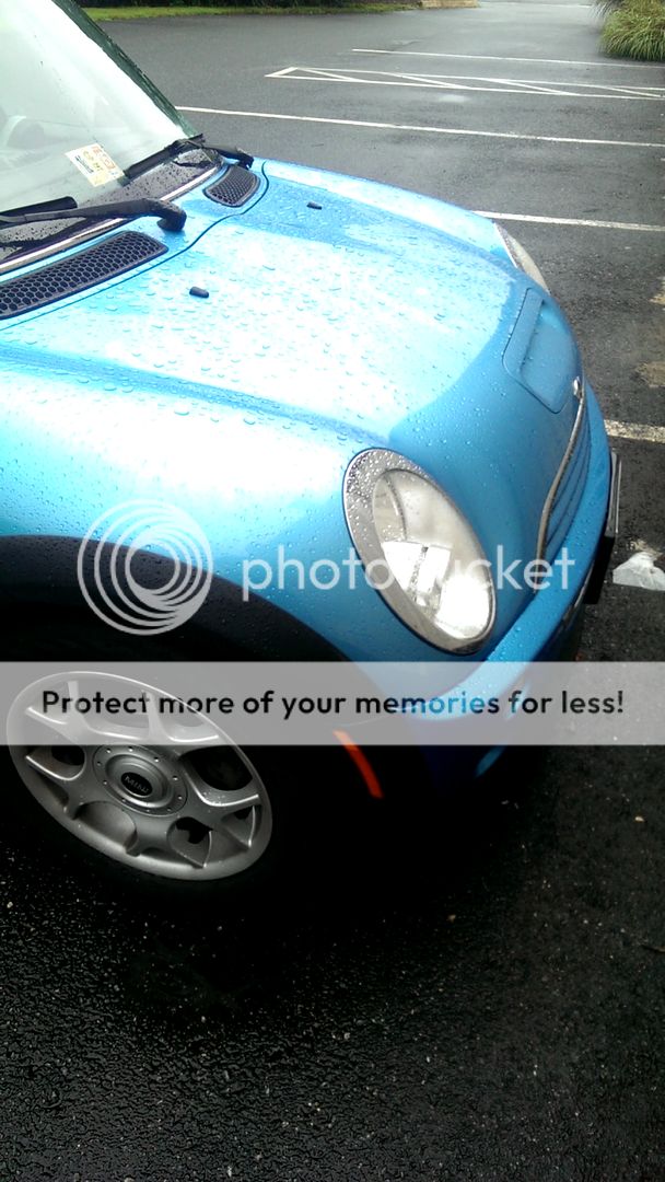

So I recently purchased this vehicle and everything seemed fine at the time. It had 102k miles on it and the 100k service had been done (stack of receipts for proof) then the other day I started to hear this weird knocking type sound or more like a bottle cap rolling around in the bottom of the engine. It is heard on the left side (supercharger side) of the engine and I cannot seem to figure out what is causing the noise. It only seems to make the noise when it is first started up and does not appear to go through the rpm range from what I can tell. Any and all help would greatly be appreciated!

From: Charlottesville Va
the picture is a link to the video on photobucket. the noise i have does not sound like that though.
Ah! Didn't realize that.
Hm not sure. On top of the timing chain guide suggestion, maybe check out the belt tensioner.
