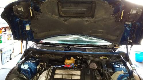

Here is mine. Clearly something is missing from the underside of the hood. I have, at the moment, pulled the bonnet scoop off to repaint so that's why the hood opening looks peculiar.

Yes there is a plastic duct piece missing. My guess is the previous owner removed it so he could use an aftermarket diverter like a DDM or M7. Mine is gone too so my DDM fits. I don't feel that piece is really necessary.
I'd be more concerned with those mushroomed strut tops.

Yes, you are missing parts. It looks like you are missing the hood scoop also.

Yeap You Missing The Scoop Part Inside Of The Hood Is This One.

Yep - I took the actual scoop off to remedy a crappy paint job from a previous owner. Scoop was painted a weird shade of black and was horribly chipped. I wet sanded it down and then plasti-dipped the scoop. Looks a thousand percent better now.

It looks like you are missing the duct that goes underneath the hoodscoop. The part number should be 51137155597 we keep it in stock and list for $67.96. We also have a coupon code TENOFF, that is goo for ten percent off an order.

Sean - does that also include the rubber gasket that seals the duct and intercooler together when the hood is shut? Seems like there are two pieces. Also, as you might be able to tell in the photo from my hood, there is an aftermarket K&N style air filter in there from a previous owner. Will that pose any difficulty with the hood vent?

The seal should be part number 51131502776. As for the filter it should not be a problem, they are typically designed to work with the scoop.
