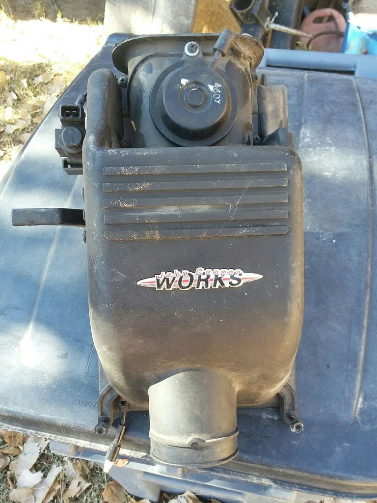

Originally Posted by quikmni
I do not know how to tell from serial number but I would suspect 200 kit since the 210 kit added JCW intake and I do not know why someone would replace JCW with Alta. The 210 kit also had the larger 380 fuel injectors. You can tell the 380 injectors by the blue body. The suspension is not part of the 210 kit and was a separate order. The JCW springs are Red. Maybe you can get some photos of injectors and springs.
Looks like it had the JCW intake, the previous owner yanked it off without knowing what it was. It comes with it, luckily.
Can I assume it's got the injectors too? It's out of state, so I can't check myself just yet.
Also, it's got big brakes, can I assume springs too?
Attached Thumbnails R53 cooper s vs. jcw-img_1900.jpg   R53 cooper s vs. jcw-img_1904.jpg   R53 cooper s vs. jcw-img_1905.jpg

If you have a BMW or Mini dealer run the JCW tag number you should be able to tell what size injectors it has. And if you take the VIN and run the decoder you might see what suspension is has. The spring package, 226, is not part of the 3AL JCW package.

JCW suspension is a completely separate purchase, not included with either factory JCW or dealer installed JCW tuning kit.
