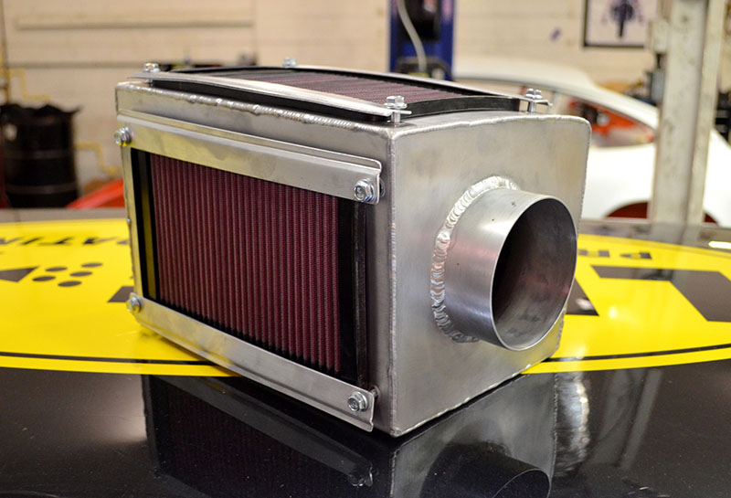

Old Sep 4, 2014 | 07:01 AM
  #100
SneedSpeed's Avatar
SneedSpeed
Joined: Jun 2009
Posts: 526
From: Pfafftown
Update - Air Box
Update - Super Cooper Air Box
Attached Thumbnails Sneed Super Cooper build thread 400WHP-air_0usmall.jpg   Sneed Super Cooper build thread 400WHP-air_1usmall.jpg
