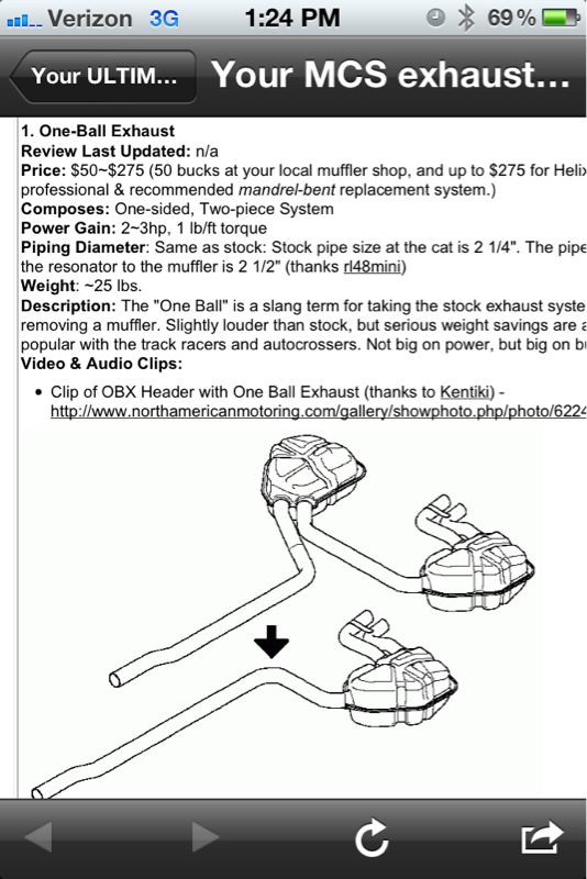

I'll be doing this mod soon (my birthday is coming up) and plan to ask the muffler shop about some kind of bracket or small pipe that can go from the left side muffler over to the exhaust hangers on the right side.
I like eliminating that resonater, increasing sound a little, but I don't want to loose any support.
Ps. There's a great diagram of the mod in the stickies, find the ultimate newby guide or something like that, then on the first page of that there's a link to a very extensive list of exhaust options.
Edit: here's the link to where this diagram is: https://www.northamericanmotoring.co...ad.php?t=23789
