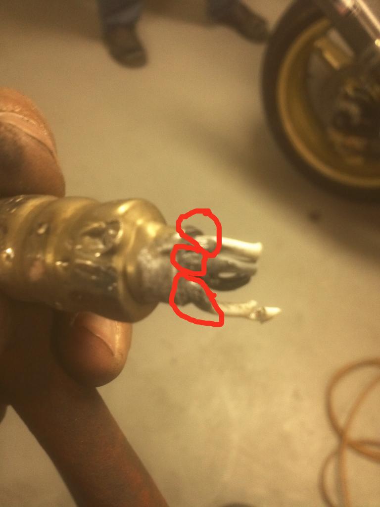

Lol haha got itttttt. Checked the engine fuses I think my second 02 send chaffed wire and caused it to pop

P0445 - canister purge valve
P0340 Camshaft position sensor - no signal
P0331 Knock Sensor 2 Circuit Range/Performance
a bad fuse will cause no power at the cam sensor, o2 heaters and purge valve; which will cause the codes you reported. The Cam Sensor is a hall effect type sensor (three wires) it requires power in order to produce a signal...no signal forces the ECU into semi-sequential mode. This means that the ECU fires all the injectors at the same time.

basically leason learned. dont rush untill you know you have plenty of time to fix your mistakes. #1 mistake was to not reweld the o2 bung. i should of just rewelded my o2 bung and this would of never happened. so i lost 125 dollars in tow. and if i cant return my cam sensor i would loose another 102 dollars. now i need to buy another o2 sensor which is 98 dollars. can anyone clarify this sensor for me???
