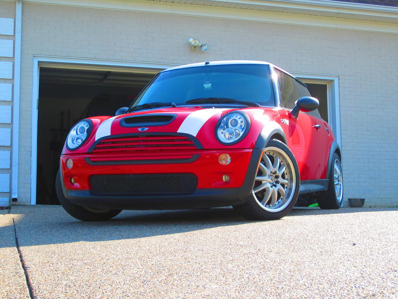

r53 exhaust valve
I was curious on how to check/replace an exhaust valve? My r53 (aka Joan) is throwing a p0304 code or misfire on cylinder 4 and was curious if it was the exhaust valves. I am handy with tools so if anyone knows of a DIY let me know.
Attached Thumbnails r53 exhaust valve-img_0490.jpg   r53 exhaust valve-img_0489.jpg
