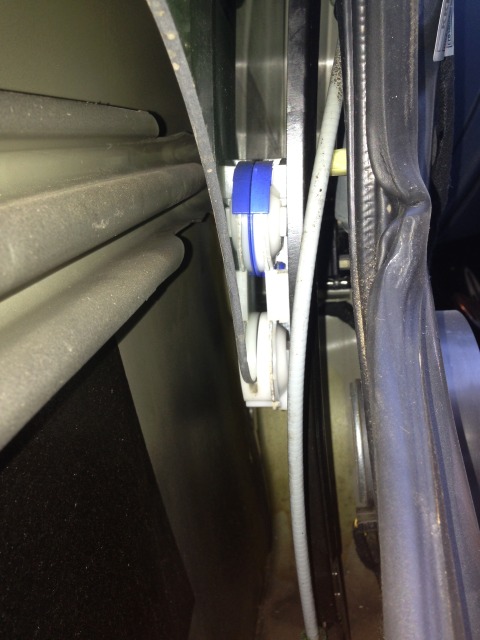

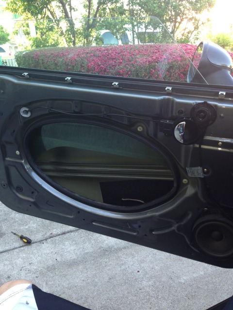

My driver side window makes a grinding gear when going down and up. It is very forced, i have to drive with the window up. what is the problem? How can i fix it?

Can you listen with the door panel off and hear which part the grind noise comes from?

yes.....7,8,9,3 that whole area. grinds and sounds like something is dying...

In looking at your photo 2, is that big star washer ( #3 in the diagram ). ... Is it touching and binding up on the metal part of the door?

I really dont know what it is, everything looks fine, it just sounds horrible and is broken, still dont know how to fix it
