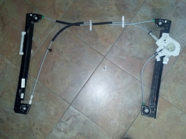

i just received my window regulator from ECSTunning and i dont think i got what i ordered
ORDER NUMBER: 733-510-753
this is what i received, the screws are missing and i seem to have gotten one window lifter (little piece in the middle)

Did it come in a box? When I ordered mine if I remember correctly I think that the screws came in a clear plastic bag, since the box had protective material I made sure that I had everything before getting rid of it, call ECS I'm sure that they can correct the problem you can always reuse the old screws, I saw you YouTube video and I think that your motor it's fine and your regulator it's messed up I don't think that you are supposed to see that cable so clearly trough the hole like that, you should be fine with the regulator you are lucky that you are able to lower your window that way you can reach the pegs and take them out without any issues, I wasn't so lucky.

Yes, it came in an ECStunning box, but no screws, i just want everything cuz i paid 170! Will be installing it asap thanks
