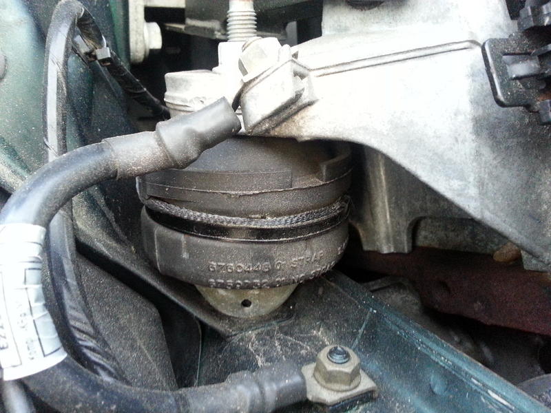

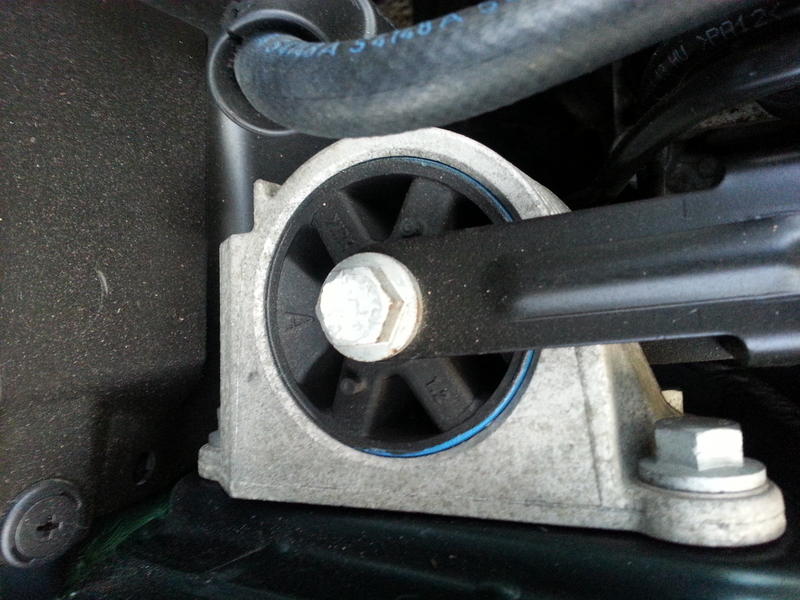

So I know I should replace my mounts to poly to put headers on but does it look like mine are good enough to stick with for a while or should I still replace them.

Both of those look almost perfect. I might recommend removing the top bolt of the big one and raising the engine slightly to see if the two halves have seperated
