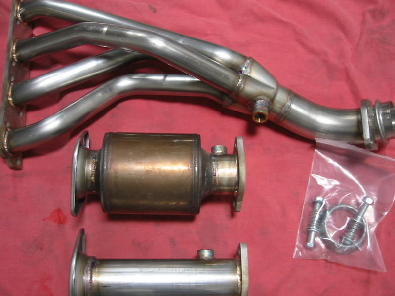

One of the biggest problems I've read about was the amount of heat produced by the car and the tendency to "burn out" cats rather quickly. I installed a Flashpoint unit from waymotorworks a few months back and it works flawlessly and I have passed my NYSE inspection with no problem. It might seem as an "expensive" repair but it's a lot less expensive compared to the dealer but looks and sounds better than the factory unit. You get what u pay for and some things aren't worth doing twice. Especially a header install in this cramped engine bay. G'luck.
I'm at a cross roads of finding an OEM unit and fabbing a "bolt in" OEM unit, or scrapping my current set up for something like Flashpoint or Magnaflow, both are comparable in price.

BTW, the rear flange of the Flashpoint unit, is that just a flat flange? Previous owner said he kept having problems with exhaust leaks from the doughnut (is there a better name for it?) flange.

We've had great luck with the flashpoint, and it does have a cat in it. Direct replacement for the stock unit, the rear flange is the same shape as a stock header so it will bolt right up to the exhaust.
