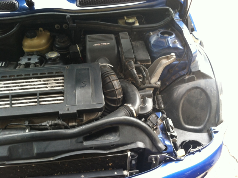

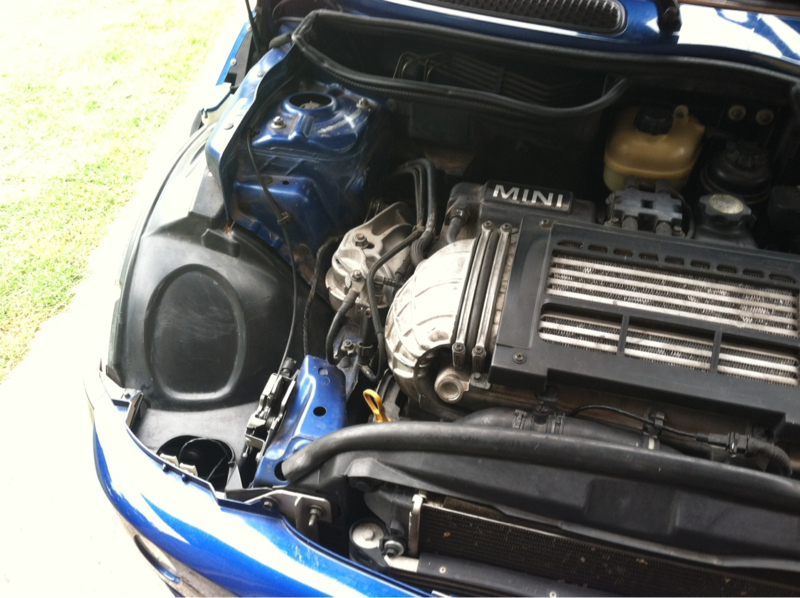

Here are some pictures of the engine bay. I am not familiar with the mushrooming but the right strut tower definitely look like it.
I was searching some threads and people said the M7 Strut Brace is pretty good.
Any other suggestions?

Those are mushroomed BAD, it may be very dificult to get the front end aligned properly, not to mention the possible problems in handling, may be very difficult & expensive to fix.
It also doesn't have a JCW air diverter:
I would be very wary of it actually being a JCW car, it will definately take more digging into, esp. If you think there asking a premium because it's a JCW car.

I could tell the right one was. But how could you tell with the left? Apparently you could lift the front end up and just take a 2x4 and a hammer and beat them back down then out a strut brace on... I'm not sure what all I would have to do, I've been searching as much as I can.
And how much is expensive? I have some money to work on a car... If it has the "true" JCW package on it then they have 2k off already. It appears to have it but doesn't have a logo on the engine head. -- I've been trying to get information on it.. It has the aero kit and exhaust.. and some type of um.. other thing in the engine bay that says JCW.. It just doesn't have the sticker on the engine head.
Someone said that it should have a serial number for the JCW, where exactly would that be?
Would the record of the JCW package be on the carfax? Probably not.. but may be worth a try.

Wow those strut towers are really mushroomed..they must have hit a pothole or gap in the road at very high speed... Check to make sure the wheels aren't bent. I've never seen mushrooming of that kind.
As for whether it's a jcw or not...someone else needs to jump in here.

Man.. How much work will the strut towers need? Have to consider this in the price. I don't mind the work.. I have friends that can help me with everything.
There is a MINI dealership close to where it's located, so I may see if I can get it checked out while I'm there looking at it. They say a BMW specialist did the maintenance on it since they've had it and their friend had it. So I would think he would realize the mushrooming..
Yeah.. it seems like it's a hit and miss with the JCW. One of the dealerships I called said he couldn't pull up records or anything so he doesn't know when it was installed, or what options were installed.
They didn't put it into the price, so I'm not too worried about that.

Well...i don't know how much work will need to go into getting the strut tower back...but i would be concerned with metal fatigue..And it won't be precise..the strut tower was originally pressed in a mold now it's going to be pounded back with a hammer and 2x4...
Let's say they can go back to normal..i cant see how the upper strut mounts wouldn't be blown after strikes that were hard enough to do that kind of damage. So you will need these:
http://www.waymotorworks.com/oem-fro...rut-mount.html
Not super intense amount of work...but still work.

Yeah.. My boyfriend has been looking online about the strut towers. And he even said that I would need new strut mounts probably. He found some strut plates on minimadness that apparently will fix the problem and also prevent it in the future.
The mini is located a little over 300 miles away. It would be a whole day to go down there and back in good daylight hours. I've been talking to the owners getting more pictures. I plan on asking about the receipts and the specialists they take the car too. I'll ask about the carfax also.
My boyfriend is going with me (He's actually studying to be an mechanical engineer) and one of our good friends is also going who is doing the same. But yeah I am looking for other cars also, just this is the first one I've come across that has everything I'd like in a MINI. I do agree it's a bit sketchy which I haven't discussed anything about looking at the car or even money wise. I'm just trying to find out more information about the car before I decide I really want the car.
It's in Jones (near Oklahoma City) Oklahoma. So if anyone is near there, feel free to PM me about it and I would love if someone could go check the car out for me. I did plan on asking them to take it to the mini dealership to get it throughly looked over.
Everything about the car seems okay, except for the strut towers / JCW works package confusion (which can be confused by "normal" people who don't know much about the cars. I didn't even know this until I went searching on the interwebzzz.) but there is a little sketch with it. Which is why I'm being cautious about it. I don't plan on looking at the car until next weekend (If I am still considering it by then)
I can tell you, that is not a true JCW vehicle.
See that Mini logo in the engine bay right behind the rad? That's supposed to say JCW with a serial number.
https://i.imgur.com/4Hf3z.jpg
My car. It has three different JCW logos. That mini you're looking at is missing two out of three, and the exhaust tip/JCW air filter could've been done by the PO.
https://i.imgur.com/3Euf2.jpg
It's harder to see, but you should see four JCW logo's.
For reference, my cooper is also a '05 MCS with JCW installed by dealer. So when I run my VIN at a regular dealership, they only list the MCS options, not the JCW. For that, you'd need to find the original dealership that sold the car.
