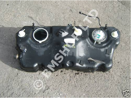

From what I have just researched, it seems as though that ring is molded into the fuel tank.
Note the ring in the top of the tank's left side (fuel pump side). Fuel filter side is the right side.

For anyone who has this problem, I did the following to fix it. Take some JB Weld and carefully build a lip where it has fractured. This may require several layers with an hour between them. Ensure minimal drippage. Come back the next day and put your ring on!
As someone previously pointed out it appears you must completely replace the gas tank to replace the plastic ring. I called several oem parts places and none had them.
