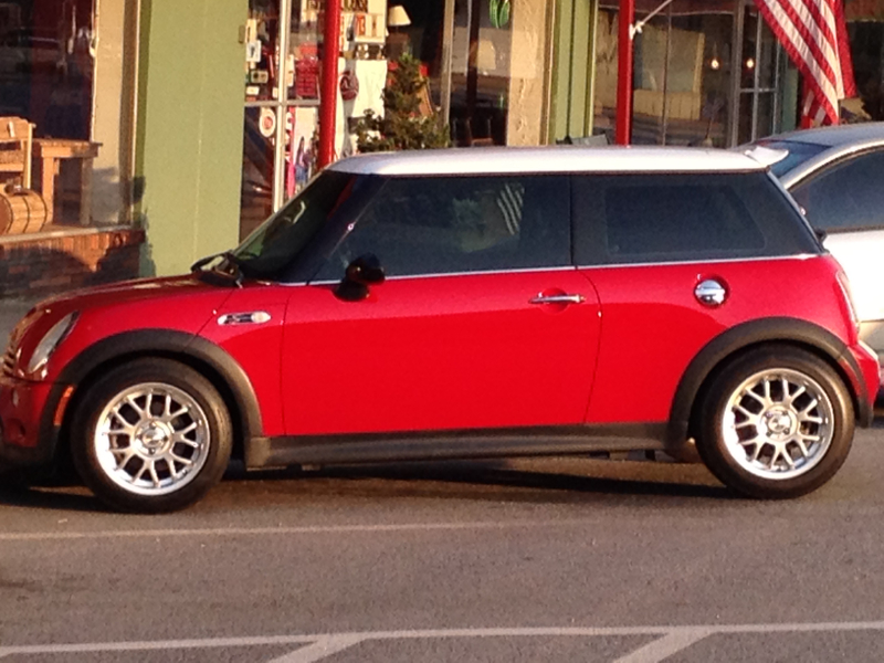

Here's a photo if it helps any
That image is hard to diagnose from but looks to be sitting correctly. My first thought is go to someone else if your professional recommends a rubber spacer. He basically wanted you to put a bump stop in there and stop your suspension from traveling..would have been pretty harsh at bumps and corners.
Second..do you have the stock strut? If it compresses with 0 resistance either in or out it is leaking all over then it was contributing to the issue but not the cause.
A worn out spring COULD be the problem but would require you taking down the rear suspension again.
Check out way motorworks in Ga if you are close if not let us know where you are and someone can reco a good shop.
no way. looks low to me. its lower than the front even. measure the gap on all 4 tires, see if its different.
I agree. Stock height has a fair amount of wheel gap. It looks like a lowered suspension.
One possible issue is that it was not realigned after lowering.

Ok, so apparently it was all about the wheels, rims, whatever you want to call them that the previous owner installed. I changed to a different set and have no issues whatsoever on 205/55/16s. I will post a pic a little later. Thanks for all the input! I really appreciate it!

Yup wrong offset and/or width can definitely do that. I still disagree that it's lowered...my 2003 sits about like that..and definitely stock.
