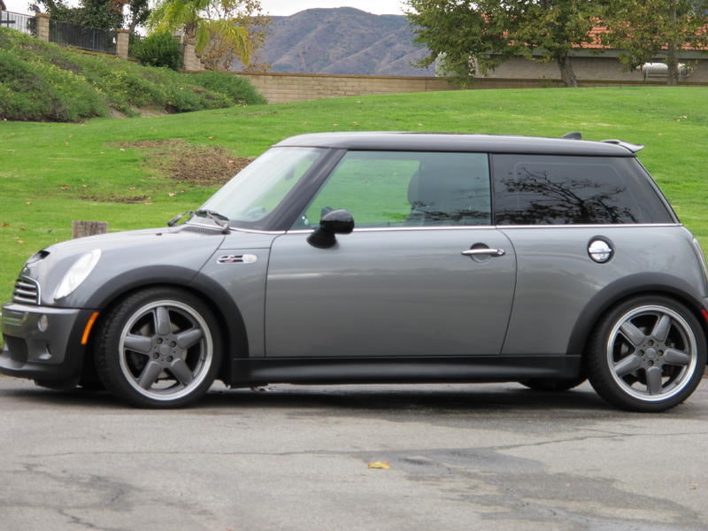

Lowering
I put M7 springs from craigslist on my car and some rear control arms from ebay... did all the work myself except for having a local shop do the alignment.
If you aren't racing or anything I would say the springs will be fine; no problems with anything on my car so far.

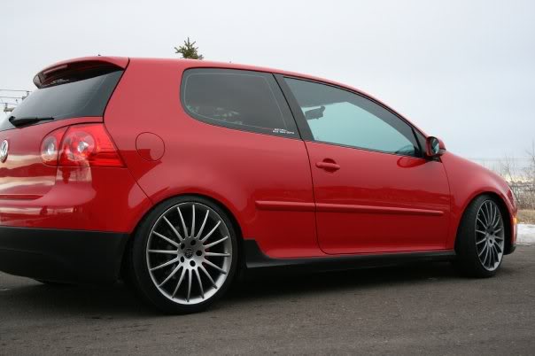

Good thread. Wanna put in my two cents of experience and, I don't know if it really applies but...I have lowered my GTI and the first set of coilovers I installed were VMaxx. They did go low but rode like Crap!!! I adjusted them throughout the entire range and they rode terrible - get what you pay for. Went with Bilstein and they made all the difference. They don't go as low as the Vmaxx but the ride is WAY better. Maybe the Vmaxx for the Mini rides better?? I'm trying to decide what to do with my R53....Bilstein coilovers or springs??
Here is a pic of the stock height and with the Bilsteins
Stock
Bilsteins
