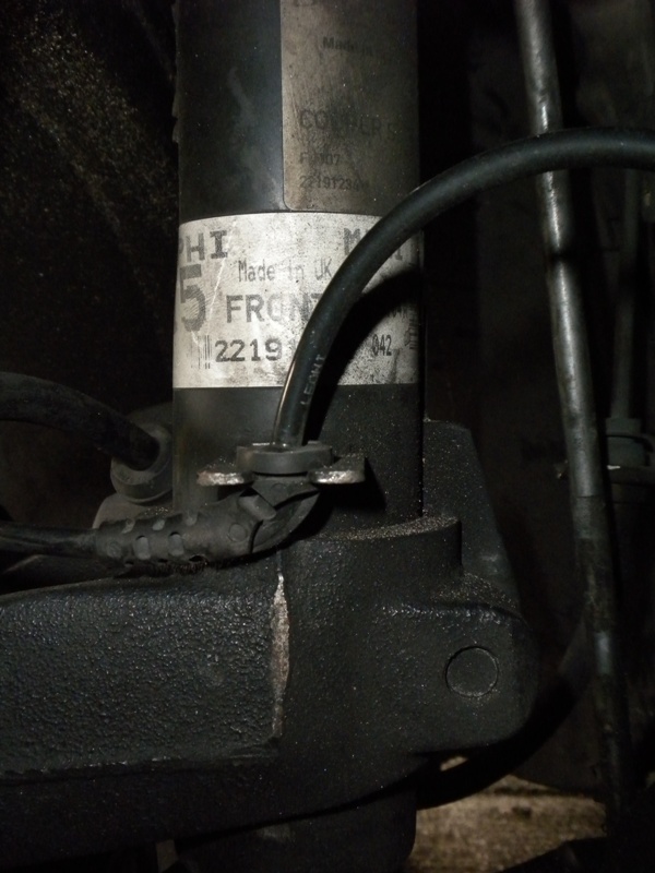

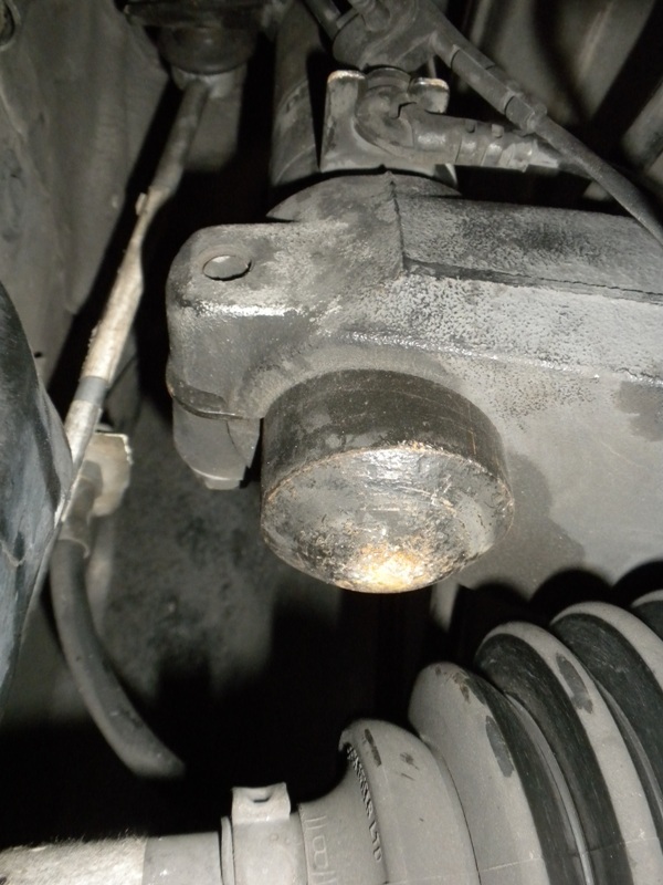

Only thing i would truly be concerned about is the bottom of the strut coming in contact with the axle, but w/o playing around it myself i cant tell for sure.
I would like to see the photos you snag though, and take some of between the strut and the axle too.

You still have quite a distance before it starts tearing into the CV boots. Coilovers like KW and Vmaxx have their brackets raised a good bit to allow the strut to sit lower in the hub and thus allow more travel at lower ride heights. He shouldn't have any problem contacting the cv boot with the limited cutting he has done.
I'd like to see pics of the tab when you have a chance
As you can see, there is clearly enough room on both sides. This is with the car up on ramps so the suspension is compressed. Notice how the bracket sits closer to the casting on top. You can see the amount I have cut off by that picture. There are still no problems there either. If I wanted to go any lower I would probably have to bend the bottom of those brackets a bit for the hose and the line to be completely clear. With 1/4" there are no issues though.
