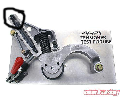

The bolt on the shock for the tensioner fell out and i need to know what size it is so i can replace it...Have a r53

no it is from the part that looks like a small shock. If you are looking down from the passengers side its the lower bolt.

this one! need length too

This guy?

Funny, I didn't see your post before I posted my pic.
Your in luck, went out and found my old tensioner, that bolt is an M8x1.25 28-29mm long.
Got it right here if needed, could mail it to you,but you probably need sooner.
