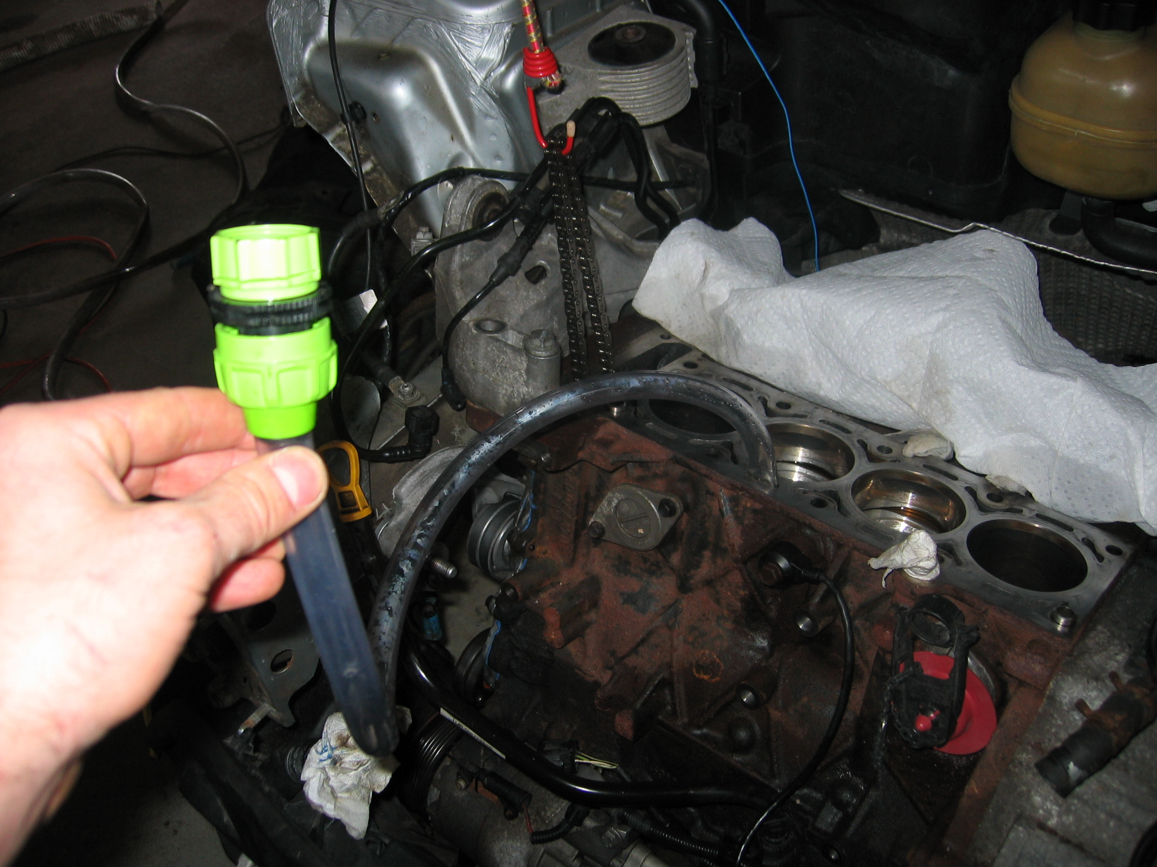

I ended up plugging the water pump port with a piece from a toilet and used a hose to fill the block with hot water through one of the jackets. I then used a shop-vac to suck it all out. Did that process a few times. I also sprayed the headbolt holes with brake cleaner and sucked it all up. Worked very well.

Now that's engineering I like!
effective and cheap. It sucks that there is no good drain for the block.
