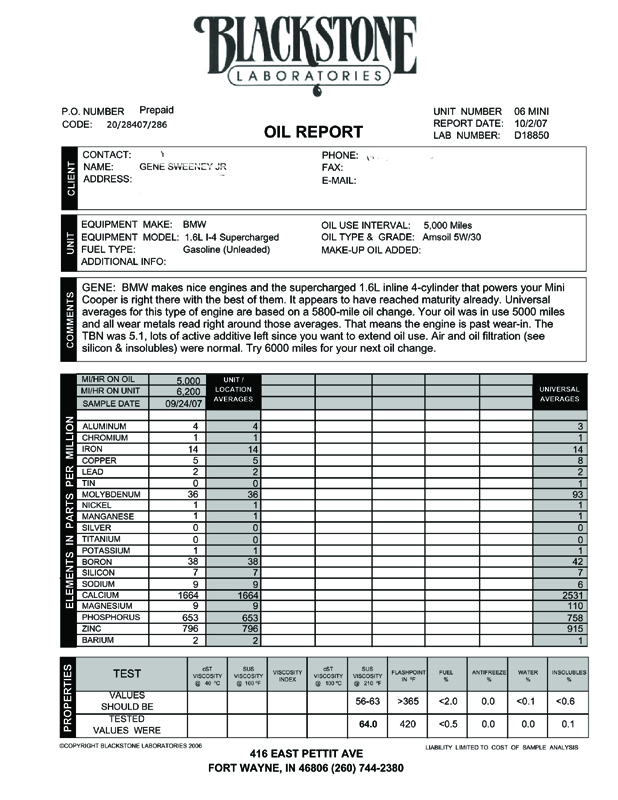

Without causing a huge uproar on oil change length, I thought I would post what Blackstone stated about my oil. I have a 06 Mini which is about a year and 3 months old. I confess I don't drive it much because I use my BMW motorcycle more and with the weather this year in Maryland, it has meant miles of smiles on two wheels. So my concern was a year on Amzoil, milage low but a year old none the less. I spoke with Amzoil and they said I should change it. Sell more oil, maybe. So off to Blackstone.
Everything looked good, but what caught me off guard was their contention I should try 6000 mile change intervals, not my current 5000 mile. Mini says 15,000, seems to be a wide gap there. I will error on Blackstone's side, but I just thought I would throw it out there and show their results.

It may be asking a lot, but can you post the UOA numbers since we can't see the pic? Or perhaps upload the pic to your gallery?

Can you post the comments section from the report?
Did you get a TBN number for that sample.
What was the grade of Amsoil oil you used?

TBN was still good at over 5. There's definitely a good amount of additive left. Blackstone might just want you to slowly extend drain intervals instead of making a huge jump.

Here is the comment section with the TBN
Here is the section you asked for. The grade with 5w-30.

The report looks really good overall. The iron is up just a tad but nothing to worry about. Perhaps you make a lot of short trips.
With a TBN of 5.1, I would say you could even go 7000 miles on your next change. I'm not certain where your TBN starts out at unless you post the exact type of Amsoil you used.
As far as BMWs recommended 15K change interval goes, I think that it is unrealistic. I would never run my oil that long.
Another oil option you could consider is the BMW 5w-30 synthetic you can get at BMW Towson. The price is not bad at around $5 a quart and holds up pretty well on 6-7K intervals.
