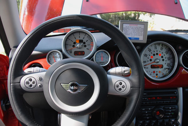

here is a pic I just snapped, so you can see what i was talking about, the power cord just hangs down and easily plugs into the lighter socket from there.

I like your positioning of the Nuvi. That's where I put mine when I'm using it. I have trouble with the lighter plug though. It doesn't make a solid contact & often turns off. I'm going to do a hard wired power cord.

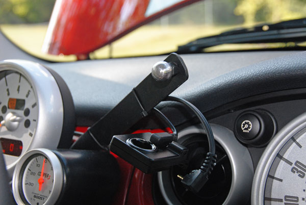

Maybe this will give you some ideas. I too had difficulty finding a place to mount my G nuvi 360. I wanted it high so I could see it without looking down and taking my eyes off the road so far, but I did not want it mounted to the windshield, so this was my solution. The metal arm is 1 x 1/8" aluminum, heated, twisted, bent and drilled to fit. The screws are longer versions of the originals. There are plastic spacers under the arm that the screws go through, they are about 1/2" tall.
The ball is a steel ball (started as 7/16") that I drilled, tapped and inserted a 1/4-20 thread. Unfortunately, the only steel ***** I could find were heat treated and I could not drill them, so I heated it to red hot, let it cool slowly, then it was easy to drill and tap. After I mounted the 1/4-20 screw, I mounted the ball with screw into a drill press spindle just to spin it and then used a hand drill with a sanding wheel on it and spun both so I could reduce the size evenly and smoothly so it would fit the socket on the stock Garmin holder. I hid the power and audio wires behind the arm. I also put a strip of the fuzzy side of velcro on the back and bent the arm so it had a little tension against the dash, so it would not vibrate. I tucked and hid all the wires and the power is hardwired, so there are no wires visible. It works great.
One thing I like is that it does not block anything and I can touch the screen while still holding the steering wheel. I just wish 'Austrailian Karen' could pronounce my local street names correctly, hehe.
If I ever take it out I'll get better pics. This is an easy one, so don't be afraid, just do it.
