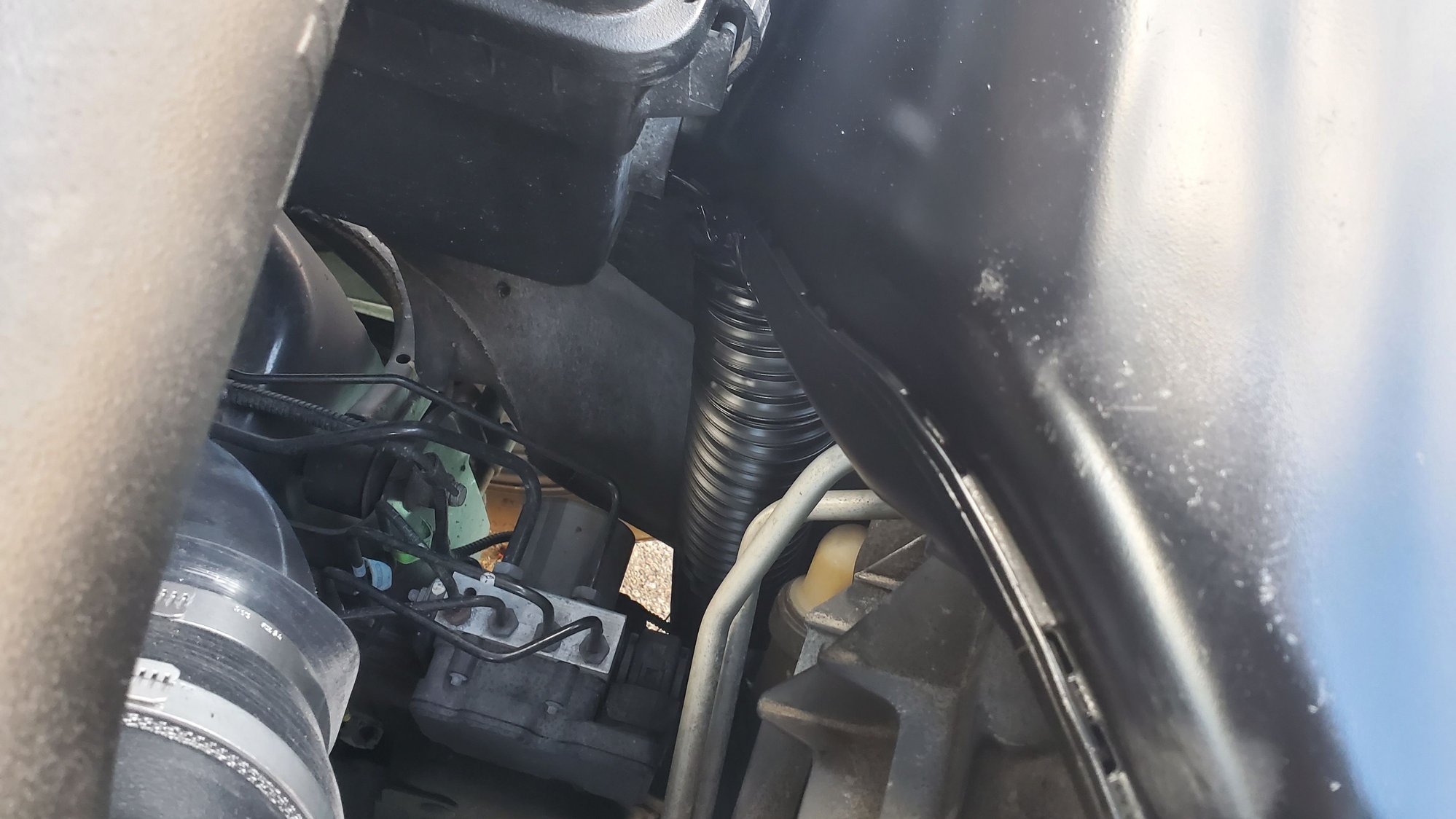

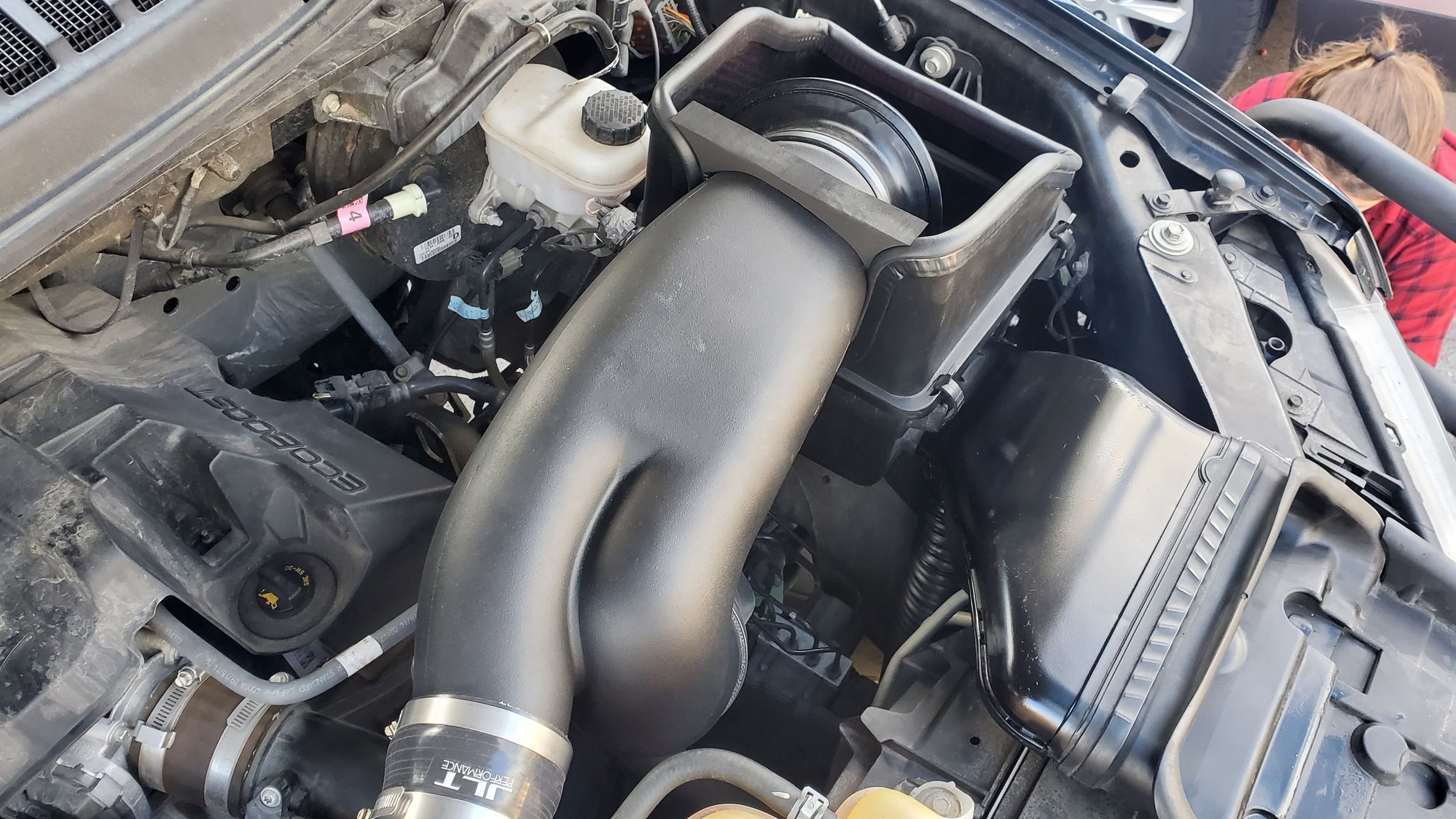

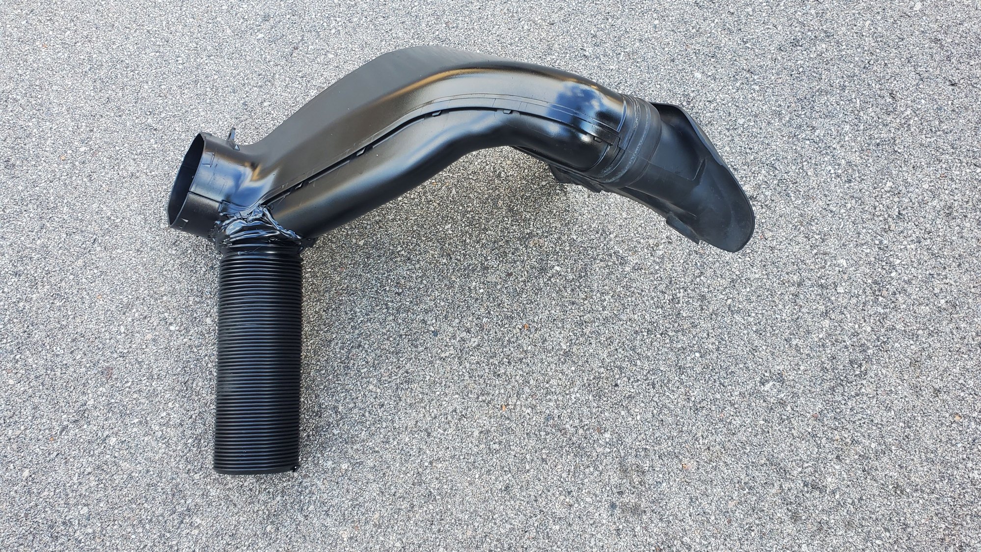

Check out this ram air intake I made for my brother's truck.
we just put on a jlt intake and I seen a perfect way to make a coldair ram for it so we I did. I even installed a mesh screen inside it to prevent debris or critters..
so far I put on a 3in lift , those tires and rims , the metal bumper/bash bar and led light behind it , underbody rust proofing and led headlights and taillights and blacked out ecobeast badges..
it's the 2.7 but it does all he needs it to do and it even with the big wheels is pulling 25freeway 18city lol which isn't much worse than what my fricken cooper gets..lol.
here's a few pics. I put a flex tube into his stock underwood ram in the bottom of it and sealed it all up and ran it down next to the wheel well and it ram from the frothe inside of the bashbar.
