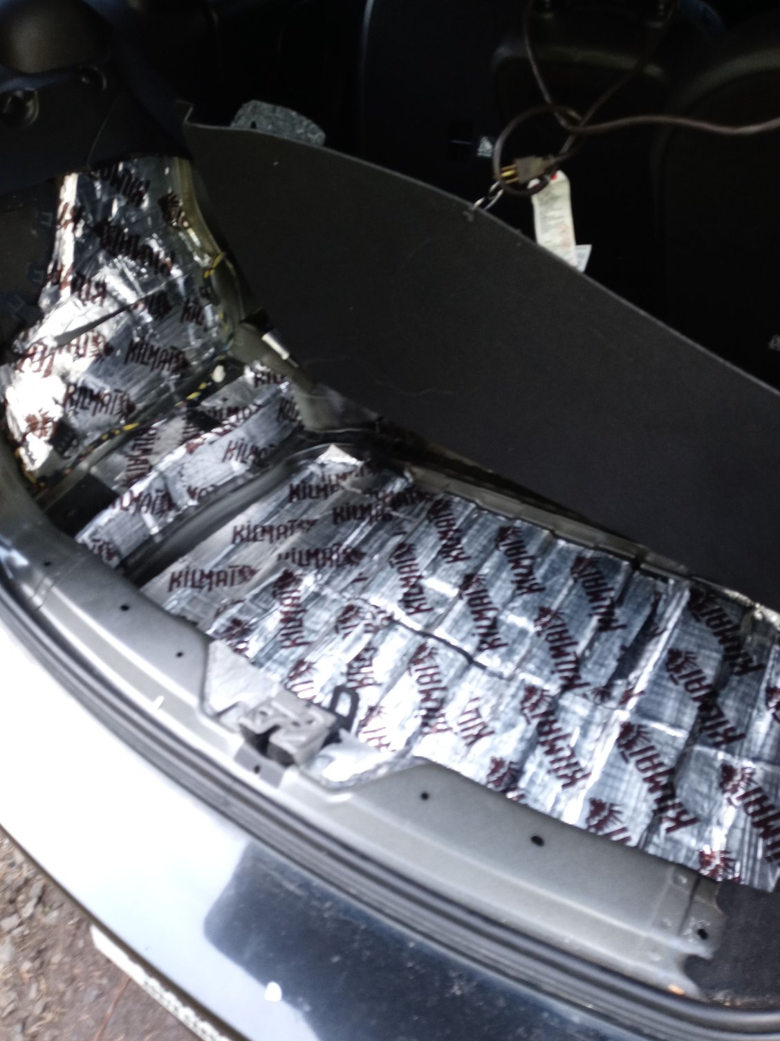

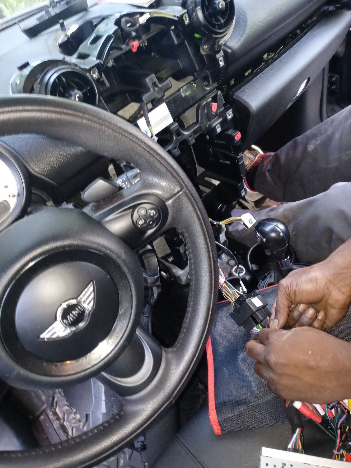

Finished in two days thanks to my neighbor. Could be done in a solid 8 hours though. Tear down of dash and install 7 inch Android 10 DVD player. Pretty much a tablet with GPS, wifi, vehicle diagnostic. Also videos and app add on. Then paired with Skar audio wizardry that it is. One 12inch sub and 1500 watts. About 2/3 of a box of 80mil Dynamat to compliment the metal bits. No one like a buzzy car.

Can you say where you connected these wires?
I installed a custom 7” alpine touchscreen and I am having a hell of a time with our 2013 R60 constantly losing memory. Can you tell me what did you connect your accessory and main power lines to?
This is actually a plug and play setup so didnt have the need to use any extra hardwiring. But you need the constant to goto the battery (yellow wire). And your ACC WIRE(red) to goto a switched fuse.
The cigarette lighter fuse is switched in the 2013 R60 but in my f55 the lighter is a constant. Just gott a have red to turn on when you turn the key
Or you can go the add a fuse adapter and one switched fuse and one constant like you would a back up camera.
