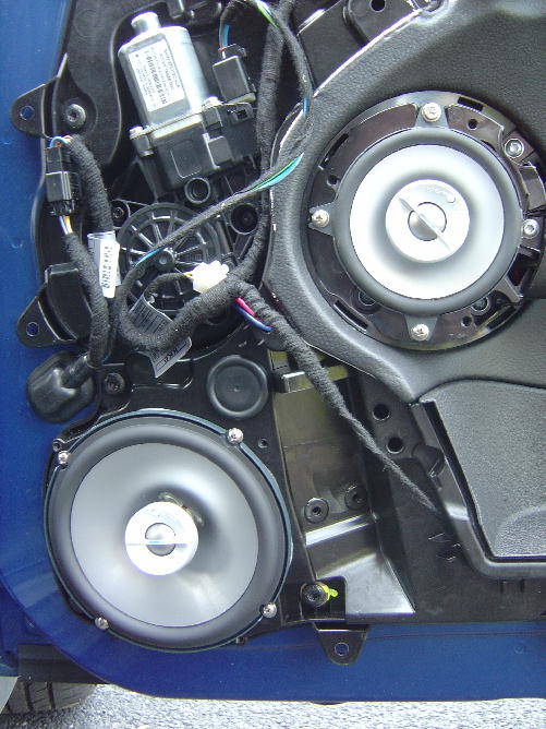

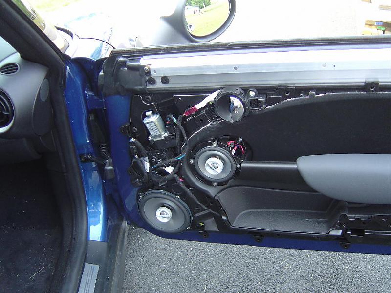

Well I am in the middle of changing out the front speakers on my MCS. Put the panel back on today and bent a few clips. Will have to buy a few more for the repair. Also, window going up and down is not sounding so good. Pulling the panel back off tomorrow to investigate. I installed Infinity ref 6022's and 4022's. The 6 1/2 inch went in smoothly. The 4" I had to use a Dremel and GRIND away some plastic. I also removed a torx screw and replaced it with a 5mm x 40mm long screw. (Wonder if this my window problem?) Still using the stock amp for everything. Was really suprised of the quality of the stock speakers that I removed. Although made in Hungary, they were of a good solid paper with rubber surrounds. I have been testing all removed speakers to find out ohmage and what is the positive and negative connections since nothing is labeled. Unless someone has a schematic of the 07' MCS. Also have the wiring colors recorded for further ref for a amp change. Finish the front panels then onto the A pillars.
Attached Thumbnails Amp and subwoofer additions!-infinity-ref.jpg   Amp and subwoofer additions!-infinity-ref-2.jpg   Amp and subwoofer additions!-infinity-ref-3.jpg
