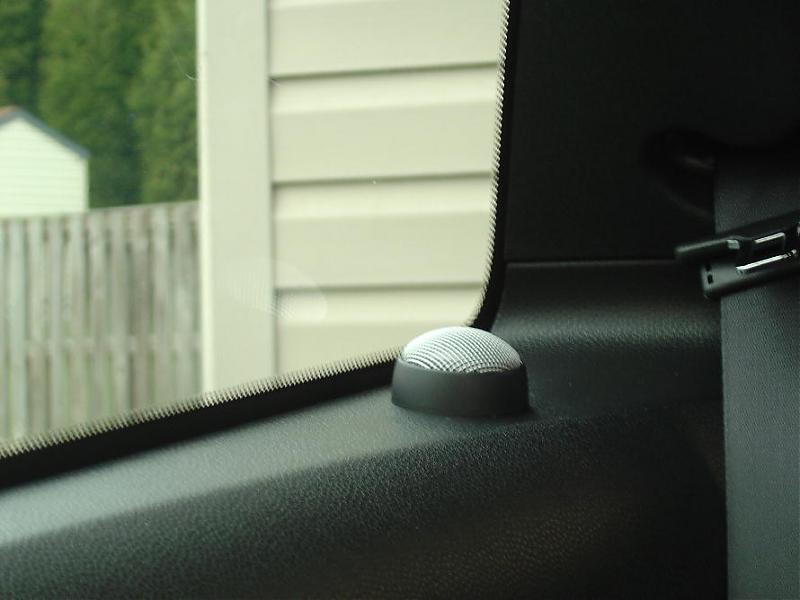

Well the rear speaker install is complete. I installed Infinity Kappa 693.7i and 10.7T in the rear. The car is all back together, (wife is happy). Just broke one small clip. I'm very happy. I came up with numerous locations to put the tweeters, some were just to tuff to do the install. I like the final position I came up with, right at head level when someone sits in the back seat, (That won't happen to much). I am still running the stock amp, things sound alot better at this time and I'm sure will get even better when the front speakers are changed out. Some years down the road, the amp will be changed out. Time to start on the front.
