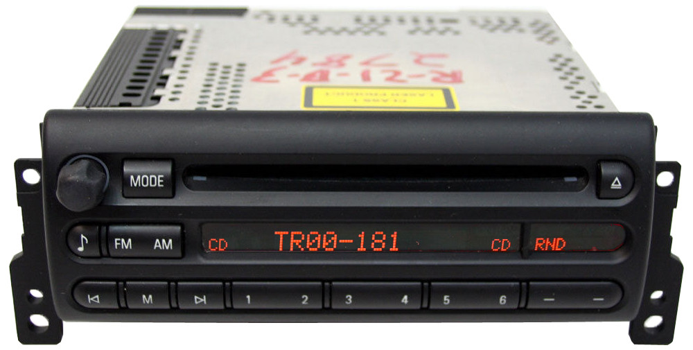

I'm the guy with the MINI HK page, HERE. I've finally hit a snag with my unit: My CD player won't work anymore. The questions I have are:
1. Can any Boost stereo head feed the HK system or do I need a special one?
2. If any Boost will do, is any programming involved or would a dropped-in Boost unit automatically acknowledge the HK amp and features?
Thanks boonches!!!
Bob

Hello,
Great write up!
Their were head units pre 1/2004 and head units post 1/2004. 1/2004+ i think is the same they just had RDS text updates R50 R53. Then their was a head unit in 2007-2008 mostly for the R52 convertible.
I believe all Gen 1 MINI head units will work used in R50-R52-R53 pre and post 1/2004. Its those weird 2007-2008 Models you have to match. The amp is on its own and just gets a single from the headunit. So you can swap out amps and headunits easliy. https://www.northamericanmotoring.co...ker-specs.html
BTW i have a rare DPSM unit for an R53 sitting in my basement.
If you want to get really rare on MINI audio I even have the r52 rear speaker orange covers. . https://www.northamericanmotoring.com/forums/navigation-and-audio/114295-my-dpsm-installation-56k-warning-lots-of-pictures.html
https://www.motoringfile.com/2006/11/28/mini-digital-power-soundmodul-reviewed/
R50 R52 R53 2002-2006 NON H/K and H/K
https://www.northamericanmotoring.co...on-button.html
As you can see the newer ones 2007-2008 even had different ****.
Get a new or used head unit and just install.
We did get a rare tape deck radio and the super rare MINI disc. But i never saw a MINI with it so chances are you will never find one by mistake'
Cassette Deck
Minidisc
Hope that helps.
