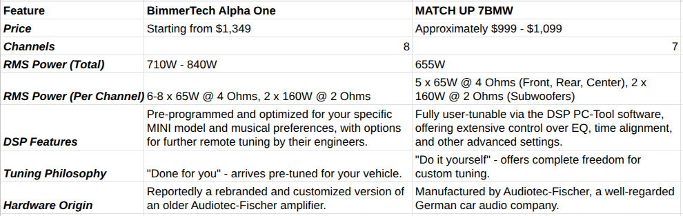

I did try to use AI for this - Gemini is on my Chromebook, and it actually brought front and center my one concern that I won't be able to do my own tuning on the Bimmer Tech amp:
Both I believe also have an RCA output to add a dedicated subwoofer amplifier for a real subwoofer, so that's a wash.
Pretty interesting that AI brought up the "tuning philosophy" here without my prompting for it, as a difference between the two.
I'll dig in a little more, but I also did this with Copilot the other day and it told me the Match Up7BMW had less power on the main channels and more power on the midbass channels, while this result is telling me they have the same power on the midbass channels.
Copilot also said that the Alpha 1 does have software for DIY tuning - I even followed up with a prompt to tell me more and it seemed to confirm it does allow it.
So I still do have to dig in to confirm the information here, but I feel like I'm leaning more towards the .Match Up 7BMW at this point anyway.
I'm also hearing good things about the Match Up7 midbass drivers for underseat - so maybe I'll pair those up. Seems like the for-sure-DIY-tuneable amp plus two midbass here might be in the same price ballpark as just the Alpha 1 where I'm apparently paying for 10 channels although I only need 7 and it's not clear what benefits there are to going that route.
