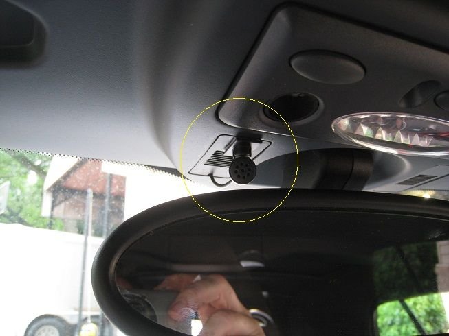

I also re-located the handsfree microphone. This position puts it closer to the driver and hides the wiring better, as the original location had it clipped to the headliner trim right against the windshield.

Congrats… and not all of us were hacks like that. Liked your relocated mic location and going to stealborrow it when we eventually do the Bluetooth aux in my son’s.

Thanks for complimenting the microphone position. I was a Program Manager at Motorola for their pro-install Bluetooth carkits back in the day (depending on when you were at BBY, you may have put in an IHF1000 or T605 carkit at some point?), and I have installed hundreds of those over the years. Keeping the microphone away from potential noise sources was always the key for best uplink audio quality, so I would try to get them in the middle of the front of the roof somehow, usually by the overhead console assembly. I never liked positioning the mic on the A-pillar (wind noise potential from a cracked or open window, as well as from the wind rushing at that point of the windshield/roof) or top of the steering column (nice direct path to the driver's mouth, but the potential for coupled noise from the hollowness of most of those trim pieces) - but I saw a lot of them installed that way.
