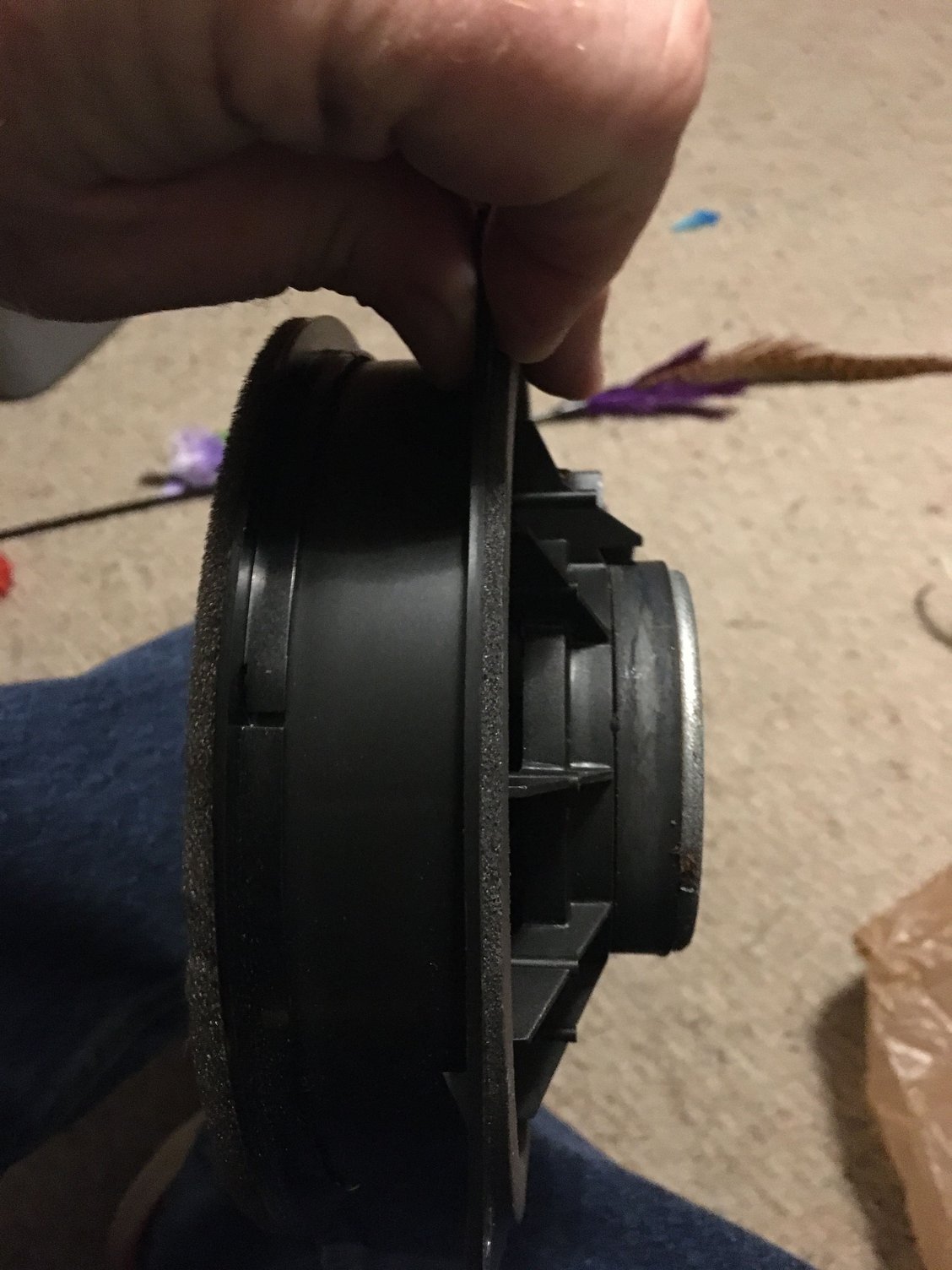

I just measured the speaker from my front door and its 300mm deep past the mount.
