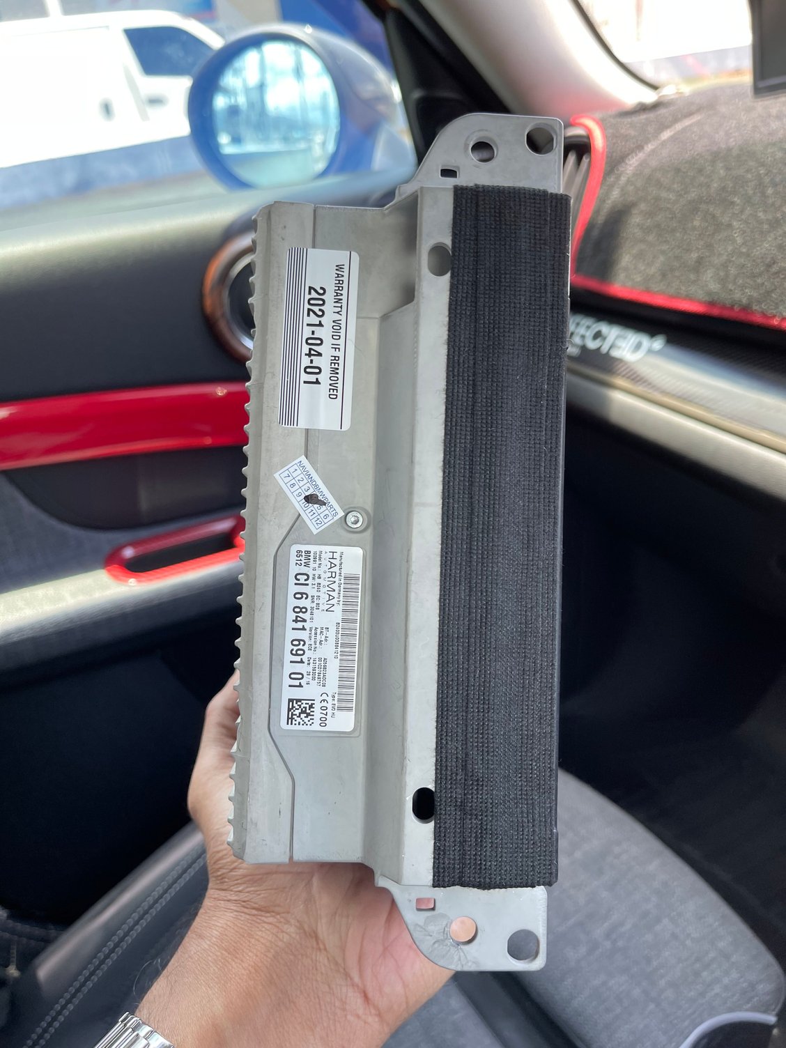

I recently upgraded my 2018 MINI Cooper CountryMan F60 Basic Media HeadUnit >>> NBT EVO ID6 With Apple CarPlay & Navigation.The HeadUnit was purchased on eBay & the VIN was precoded before shipment & lated fine tuned to my system via remote coding by the seller from Lithuania.
